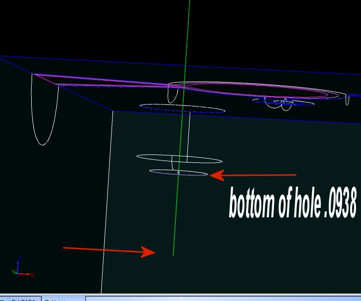

    have set up a ream feature and it wants to go too deep and I can’t figure out why.
    the drill cycle is drilling to a depth of .239″
    the depth is set at .0938″
    What am I missing?

  • Profile picture of dlaery dlaery said 1 year, 3 months ago ago:
    I was hoping someone could look at my file to see what I am doing wrong.
    I can enter negative numbers, enter zero and it doesn’t changed the drill depth. I can enter a negative number and it still doesn’t change the drill depth.

    There is no finish. I already deleted it. the video is hard to see if you don’t maximize it. Al I want it to do is spot drill, drill a hole and the run the reamer. In Ver 23 I could set the drill depth to a negative to get to the right depth because I could never get it to work like is was suppose to. In ver 24 I haven’t figured out how to correct that.
    I think something is wrong with BobCad. But I’ve been wrong before and be willing to admit it is my fault. I just want it to drill the right depth.
    In the code it is going to a depth of Z-.1875
    Here is the answer to my problem posted in the Zone:
    Originally Posted by billb95
    If you look at your cutting conditions and check in the parameters section, you will probably find that in the ream section under “ream primary hole depth” there is to big a figure in it. Change this to zero and check your code.
    This is V23.
    Hope that makes sense and is of some help.
    WOW
    That did the trick.
    Now it is not broke anymore.
