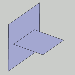

The boundary options determine how the fillet is trimmed at the outer boundaries. The following image shows the two original surfaces as a reference to the result shown below each option.
Blend - creates the fillet by trimming it and creating a tangent blend with the surface edges.
No Trim - creates the fillet between the two surfaces, but does not trim the outer edges of the fillet. The resulting fillet exceeds the larger surface by the radius amount.
Minimal - creates the fillet using the smaller surface.
Maximal - creates the fillet using the larger surface.
Bevel - create the fillet by trimming it and creating a beveled edge between the two surfaces.

Part 7) Selecting the Geometry
In the Corners group, of the Create 3D tab, click Surface Fillet.
The Fillet Surface dialog opens in the Data Entry Manager. -
Hover over the surface created on the Front Plane as shown in the image below.
Select the surface.
The surface is added to the First Surface/Solid list.
Hover over the surface created on the Top Plane as shown in the image below.
Select the surface.
The surface is added to the Second Surface/Solid list and the Preview appears showing the result if the default Blend option is used.
