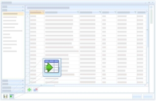

Tool Library Interface
Tool Panel Bar
The left-most portion of the Tool Library is the Tool Panel Bar which groups the tools. The tool are divided first by Drill, Mill, Lathe, Laser, Plasma, and Waterjet. Clicking on a particular group will display the available tool types in that group. Finally, clicking on a particular tool type will show all the tools available tools of that type.
Tool Grid View
With a particular tool type selected, the Tool Grid View will show all the available tools of that type. From this point you can add tools, or highlight a particular tool to delete it.

Importing a Library
To use an existing library:
- Click the
 Import from file button on the bottom left.
The Open dialog appears. - Locate and highlight the appropriate file.
 - Click Open.
The library is updated based on the imported file.
