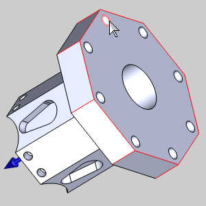

  6. Hover over the back edge as seen in the image below.

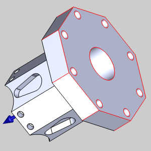

  7. Select the edge along the outer diameter of the part as seen in the image below.
  8. Repeat this for the remaining edges.
  9. Rotate the part and select the edges on the back.
    With these edge selected, we will avoid the cutting the jaws holding the part in place.
  10. Click OK.

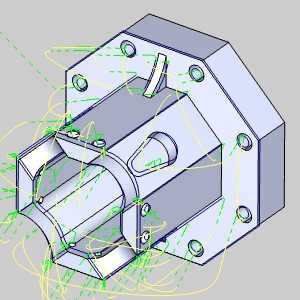

  5. Click Play to view the current operation.
    Notice the crash.
    We will need to adjust the allowable angle of tool to correct this.

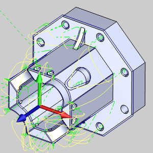

  4. In the Tilting group, select the Tilt range check box.
  5. Set the Min. value to 25.
  6. Click Compute.
    Notice the slight tilt of the toolpath now.
Part 10) Simulation
    Notice the part is now cut without collision.
