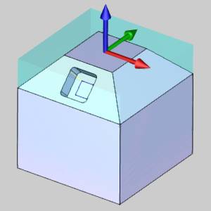

Index Systems
The Index System defines the rotary angles used for 4- or 5-axis indexing. You add an Index System to define each plane of the part that is machined. To define the plane, you can select a surface or a UCS (user coordinate system). Milling Features can then be created for each Index System. When you use Index Systems, the complete program (including the indexing of the part) can be viewed in simulation.
You can also create indexing programs using the Output Rotary Angle option in the Posting dialog box of the Milling Wizard. This method creates proper indexing in the NC program, but the indexing of the part is not shown in simulation.
Important: Wrapping Groups are only available with the 4 Axis Standard, 4 Axis Pro, 5 Axis Standard, and 5 Axis Pro modules.

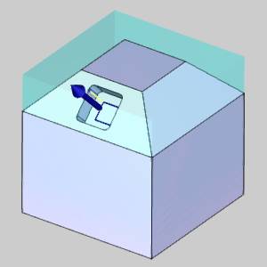

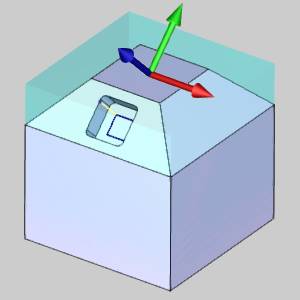

Important: When you select a surface or plane to set the index location, the surface or plane becomes the Z-axis zero for setting the feature parameters.
- Reverse Direction - is
used to flip the Z-axis indicator of the index system when the
indicator points in the wrong direction. The index system indicator
should point in the positive Z-axis direction (towards the milling
spindle/tool).

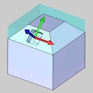

Using the Index System
Rotation angles are automatically set in features created using an Index system as long as the proper procedure is followed.
The Proper Setup Procedure:
Define the stock geometry and Machine Setup for the part.
Add an Index System, and assign the plane for the index system before adding features.
When you add features, you must right-click the Index System (not the Machine Setup) to automatically pick up the proper rotation angles.
(If you add a feature from the Machine Setup, the feature isn't added to the Index System.)
Note: When you select a surface/plane to set the index location, the surface/plane becomes the Z-axis zero for setting the feature parameters.
