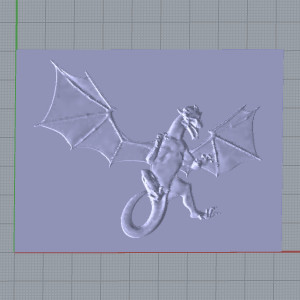

In the example file provided, an Emboss from Image feature has already been created. After working with the file, some unwanted artifacts were created in the emboss. In this example, you learn how to use Sculpting to clean up these areas of the model.
The currently defined feature used in this example is shown next.
