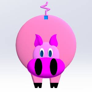

Pig Art Emboss Tutorial
This tutorial is designed to help you become familiar with the BobART Emboss features. The Emboss Regular, Emboss Swept, and Emboss 2-Rail Sweep features are used to create a piggy-bank BobART model. Follow this tutorial along with the other Emboss tutorials to learn more about the BobART Emboss features.

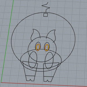

Part 2) Define the Canvas
  1. In the BobART Manager tab, right-click Emboss Model, and click Create/Modify Canvas.
    The Canvas Definition dialog opens.
  2. By default the UCS is set to World Top which is the desired UCS for this example.
  3. In the Model Size group, set the X value to 229.000, and set the Y value to 305.000.

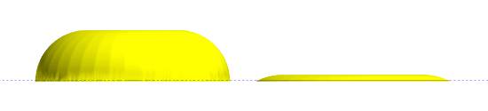

Note: The resolution updates automatically as the size is updated. The Resolution will improve the quality of the model, but also increase the size of the file, and the amount of time it takes to regenerate the surface.
The image on the left shows stock with a resolution of 25, while the image on the right shows stock with a resolution of 150.
Normally, since ultra fine details will not be visible on the final machined part, a higher resolution stock is not really needed. However, if it is wanted, wait until the model is complete and adjust the resolution at the end. This will keep regeneration times low during the creation of the model.
  1. At this point, as an option, you can also select the Remove Non-Emboss Area check box.
    This will remove any area of the canvas that is not being utilized by a BobArt feature.
  2. Click OK.
    The canvas appears in the graphics area.
  3. Click Cancel.
    The Canvas Definition dialog disappears.

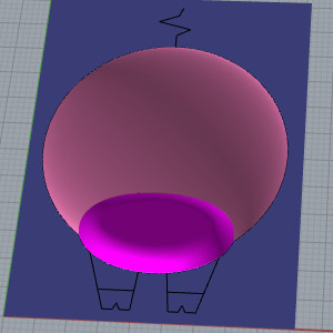

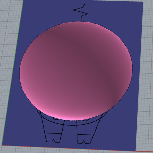

Part 3) Regular Emboss 1 - Body
Create the feature and set Attributes
  1. In the BobART Manager tab, right-click Emboss Model, and click Emboss Regular.
    The Emboss Regular dialog opens.
  2. For the Name, add Body to the front of the text so our feature name reads Body Regular Emboss 1.
  3. Click the drop down next to Color, and select More Colors....
    The Select Color dialog appears.
  4. In the vertical color spectrum bar, click on the pink area, or you can use R 250, G 125, B 200 values, then click OK.
    The Select Color dialog disappears and the color is set to pink.
    By default the Application Type is set to Add and the Selected Geometry list has focus.

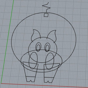

Select Geometry

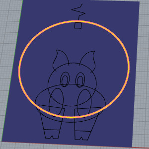

  1. In the graphics area, select the geometry that represents the body of the pig as shown next.
    The geometry is added to the Selected Geometry list.
Define the Cross-Section
  1. Click the Cross-Section option to access the drop down list, and select Convex Ellipse.
  2. Set the X Axis Radius value to 102.000.
  3. Set the Y Axis Radius value to13.000.
    The body is now embossed and appears as shown next.
  5. Click Cancel to exit the dialog.

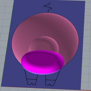

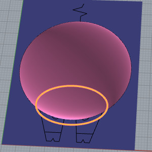

Part 4) Regular Emboss 2 - Nose
  2. For the Name, add Nose to the front of the text so our feature name reads Nose Regular Emboss 2.
  4. In the vertical color spectrum bar, click on the darker pink area, or you can use R 255, G 0, B 255 values, then click OK.

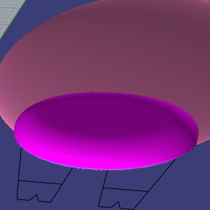

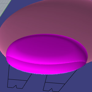

  5. Set the Application Type to Merge High.
Select Geometry
  1. In the graphics area, select the geometry that represents the nose of the pig as shown next.
  1. With Convex Ellipse still selected as the Cross-Section, set the X Axis Radius value to 19.000.
    Leave the Y Axis Radius value at 13.000.
  2. Click OK to update the canvas.
    The nose is now embossed and appears as shown next.
    For comparison, an image of the same feature is shown using the Add application type as mentioned previously.
  3. Click Cancel to exit the dialog.
Note: Most, but not all of the nose geometry overlaps the body geometry. Merge High is used to create the nose with one consistent height. If the Add application type is used, then the area of the nose that does not overlap the body geometry would not be the same height as the rest of the nose (this is shown at the end of Part 3). Merge High leaves only the highest area of intersection between two embossed features.
Tip: To hide or show the stock, right-click Emboss Model and click Blank/Unblank. This is helpful when you have already created an Emboss feature but need to select geometry that is hidden within (or behind) the stock model.

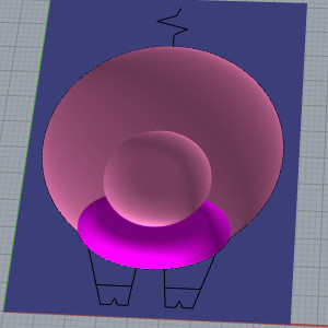

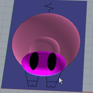

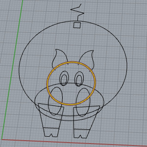

Part 5) Regular Emboss 3 - Face
  2. For the Name, add Face to the front of the text so our feature name reads Face Regular Emboss 3.
  4. In the vertical color spectrum bar, click on a slightly different pink area, or you can use R 255, G 128, B 192 values, then click OK.
  5. The Application Type should still be set to Merge High which is what we want for this part.
Select Geometry
  1. In the graphics area, select the geometry that represents the face of the pig as shown next.
  1. Click the Cross Section still set to Convex Ellipse, update the X Axis Radius value to 26.000.
  2. Set the Y Axis Radius to 6.000.
    Notice that the face emboss does not show. This is because the height of the body is greater than the height of the face, and the Merge High application type is used.

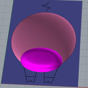

Update the Base Height
  1. In the Base Height field, enter 13.000.
    This adds a 13.000 mm foundation to the base of the emboss feature which can now extend up through the body.
  2. Click OK.
    The result should look as follows.
    Notice that the face now covers the nose. This is not the desired result either. To resolve this issue you add a base height to the previous nose emboss operation as well.
  3. Click Cancel.

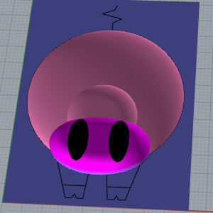

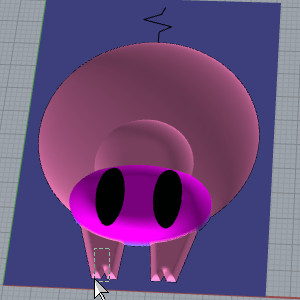

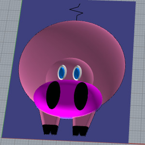

Part 6) Regular Emboss 4 - Nostrils
  2. For the Name, add Nostrils to the front of the text so our feature name reads Nostrils Regular Emboss 4.
  3. Click the drop down next to Color, and select Black.
  4. Set the Application Type to Subtract.
Select Geometry

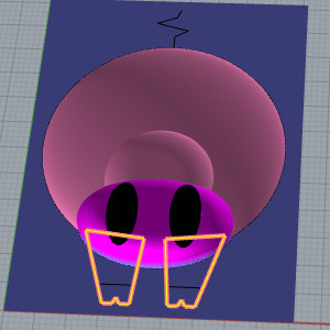

  1. Set the Cross-Section to Convex ARC.
  2. Set the Radius value to 6.000.
  3. In the Start Angle field, enter 60.00.
  4. Confirm the End Angle is set to 90.00.
  1. Set the Base Height to 0.00.
  2. Click OK.
Tip: Notice that the Start Angle is changed to 60 degrees, instead of 0 degrees. The embossed model now starts 60 degrees into the defined Cross Section. The result is that the edge of the model has a more gradual slope in relation to the stock. The following image shows two identical Regular Emboss features with the first starting at 0 degrees, and the second starting at 60 degrees.
It is important to explore the various settings of the Emboss features. Changing one setting can create a substantial difference in the result. By experimenting with the different settings, you can find multiple ways to accomplish the same task, with variations in the result. Knowing these variations helps you greatly when creating embossed models.
  1. Click Cancel to exit the dialog.

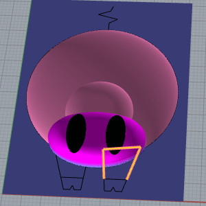

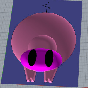

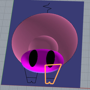

Part 7) Regular Emboss 5 - Legs
  1. Right-click Emboss Model, and click Emboss Regular.
    The Emboss dialog opens.
  2. For the Name, add Legs to the front of the text so our feature name reads Legs Regular Emboss 5.
  3. Click the drop down next to Color, and select the pink we used for the body in the Recent Colors area.
  4. Under Application Type, click Merge High.
Select Geometry
  1. In the graphics area, select the geometry that represents the legs of the pig as shown next.
    Repeat this process for the other leg.
  1. Leave the Cross-Section set to Convex Arc with a 6.000 radius, but update the Start Angle value to 0.00.
    Leave the End Angle at 90.00.
  2. Click OK.
  3. Click Cancel.

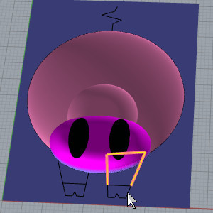

Part 8) Regular Emboss 6 - Feet
  2. For the Name, add Feet to the front of the text so our feature name reads Feet Regular Emboss 6.
    The Color is set to black.
  4. Under Application Type, click Add.
Select Geometry
  1. In the graphics area, select the geometry that represents the feet of the pig as shown next.
    Then repeat this process for the other foot.

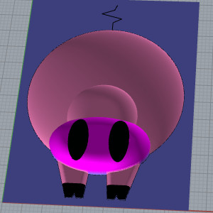

  1. Leave the Cross-Section set to Convex Arc, but update the Radius value to 3.000.
    Leave the Start Angle at 0.00 and the End Angle at 90.00.
  2. Click OK.
    The result should look like next image.
  3. Click Cancel.

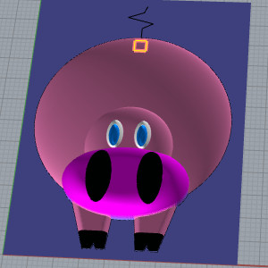

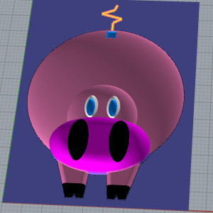

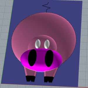

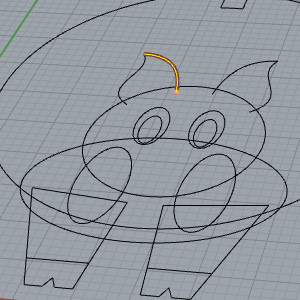

Part 9) Regular Emboss 7 - Eyes
  2. For the Name, add Eyes to the front of the text so our feature name reads Eyes Regular Emboss 7.
  3. Click the drop down next to Color, and select White.
    The Color is set to white.
Select Geometry

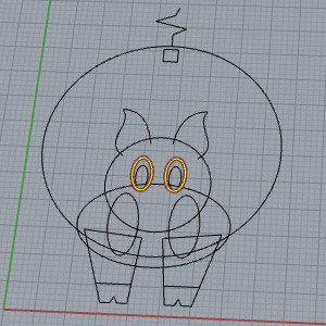

  1. In the graphics area, select the geometry that represents the eyes of the pig as shown next.
  1. Leave the Cross-Section set to Convex Arc but update the Radius value to 3.000.
    Leave the Start/End Angles at their current values.
Set the Base Height
  1. In the Fast Edit section, update the Base Height to 19.000.
  2. Click OK.
    The result should look like the previous image.
  3. Click Cancel.

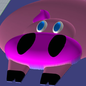

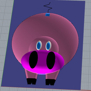

Part 10) Regular Emboss 8 - Pupils
  2. For the Name, add Pupils to the front of the text so our feature name reads Pupils Regular Emboss 8.
  3. Click the drop down next to Color, and select Blue.
    The Color is set to blue.
Select Geometry
  1. In the graphics area, select the geometry that represents the pupils of the pig as shown next.
  1. We will be using all the same values in the Cross-Section section.
  1. Set the Base Height value to 0.00.
  2. Click OK.
  3. Click Cancel.

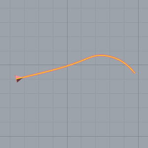

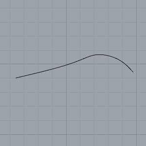

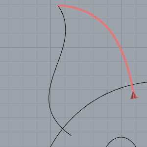

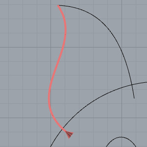

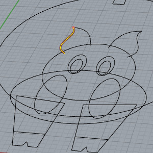

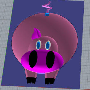

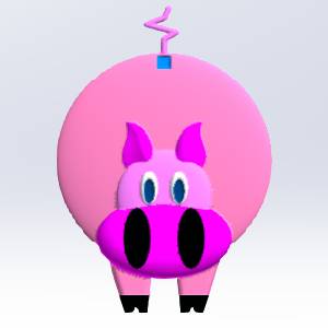

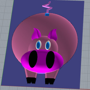

Part 12) Swept Emboss 10 - Tail
  1. Right-click Emboss Model, and click Emboss Swept.
  2. For the Name, add Tail to the front of the text so our feature name reads Tail Swept 10.
  3. Click the drop down next to Color, and select the pink used for the nose in the Recent colors group.
    The Color is set to pink.
  4. Set the Application Type to Merge High.
Select Geometry
  1. In the graphics area, select the geometry that represents the tail of the pig as shown next.
Tip: Notice that the tail geometry is not a closed entity. This is why the Emboss Swept feature is used. The Emboss Swept feature allows the use of open or closed feature geometry, and it creates an emboss using the geometry as the center line for the feature.
  1. The same values are used in the Cross-Section section.
    Click OK.
  2. Click Cancel.
    At this point, the feature tree is becoming rather large. You may want to collapse a few of the features to save space in the BobART Tree. To collapse the features, click the icon next to each feature name.
Part 13) Emboss 2-Rail Sweep 11 - Right Ear
  1. Right-click Emboss Model, and click Emboss 2 Rail Sweep.
  2. For the Name, add Right Ear to the front of the text so our feature name reads Right Ear 2 Rail Sweep 11.
Select Geometry
  1. Rail 1 : By default, the Selected Geometry list in the Rail 1 group has focus.
    1. In the graphics area, select the geometry that represents the outer edge of the pig's right ear as follows.
    2. Click in the Profile Chains list to ensure the direction points up away from the pig's face as shown in the image below.
    3. Click the Reverse Direction button as needed.
      The effect this direction can have on the end result can be viewed in the table at the end of this section.
  2. Rail 2
    1. In the Rail 2 group, click in the Selected Geometry list so it has focus.
    2. In the graphics area, select the geometry that represents the inner edge of the pig's right ear as follows.
    3. Click in the Profile Chains list to ensure the direction points up away from the pig's face as shown in the image below.
    4. Click the Reverse Direction button as needed.
  3. Cross-Section
    1. Click in the Selected Geometry list in the Cross-Section group.
    2. Select the geometry to the left of the canvas.
    3. Click on the Profile Chain and ensure the direction is to the right.
Set the Base Height and update the canvas.
  1. In the Base Height field, type 13.000.
  2. Click OK.
  3. Click Cancel.
Rail 1 direction Rail 2 direction Cross-Section direction Result
When both rails point in the same direction, rather than opposing directions, the result can be adjusted with the direction of the Cross-Section. Notice the result above with the Cross-Section direction pointing to the right.
Now notice the result with the Cross-Section pointing to the left.
The results with rails in opposing directions will normally be unwanted regardless of the Cross-Section direction.
Part 14) Emboss 2-Rail Sweep 12 - Left Ear
Insert and Edit the Feature
  2. For the Name, add Left Ear to the front of the text so our feature name reads Left Ear Regular Sweep 12.
Set the color and application type
  1. For this feature we use the same color and Application Type.
Set the geometry
  1. Repeat the same steps used for the previous ear.
    Use the outer ear entity as the first rail and the inner ear entity as the second rail. The cross section geometry direction is the same as for the right ear.
Important: Be sure the direction of the profiles chains matches what was used for the previous feature.
  1. We use the same Base Height as in the last feature.
    Click OK.
    The result should match that in the image above.
  2. Click Cancel.
Part 15) Update the Canvas Resolution
  1. Now right-click Emboss Model, click Create/Modify Canvas.
  2. In the Resolution field, type 13.
    This improves the appearance of the embossed model.
  4. Click Cancel to close the dialog.
This concludes the tutorial.
