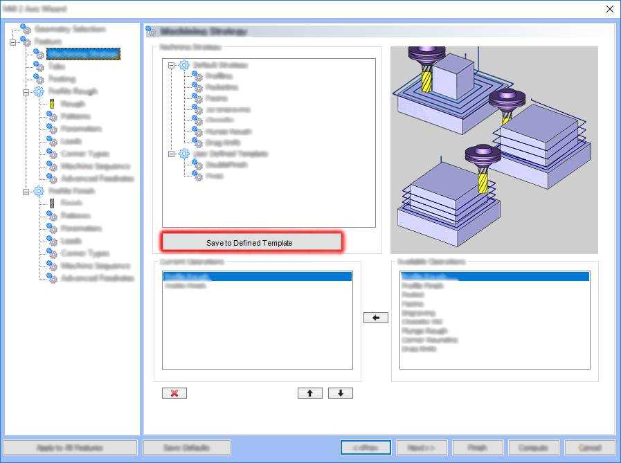

The corresponding Wizard launches. - Click Next>> twice to move to the Machining Strategy page.
Notice the Save to Defined Template button at the bottom of the Machining Strategy group. This is the option we will use later, but for now, move through the wizard and alter the tools of the selected operations, and any of the values you would like to be set differently the next time this User Defined Template is used.

- Once all the tools and operation values have been updated in the wizard, move back to the Machining Strategy page.
- Click the Save to Defined Template button.
Notice the name of our User Defined Template now appears in the list. - Click on our new template.
The operations used in our template automatically populate the Current Operations list.
