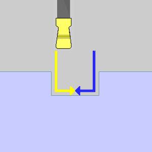

Force Down Cutting -
selecting this option will force the semifinish to be cut from each side
of the groove one at a time, each in a downward direction, to the middle

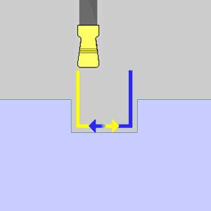

of the groove. Adding an overlap will set each pass to go past the center
of the groove half the specified amount.
Overlap - sets the total distance between the two passes exits, not including any leads that are uses.

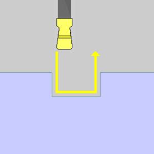

Basic Finish - sets
the semifinish pass to one single direction.

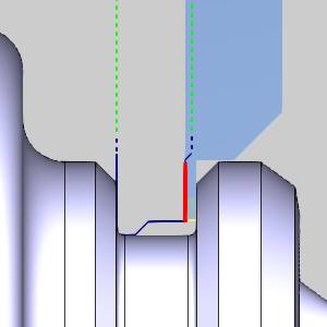

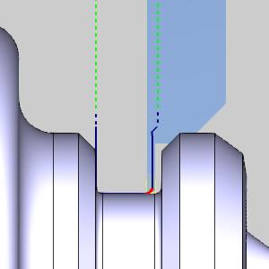

Each tool has a theoretical point placed on it as seen in red in the animation below. In the case of tools with a radius of any size, this point is not actually on the tool, but on the horizontal and vertical intersections of the radius. It is this point that the toolpath plots out. When compensation is used, it is designed to place the actual tool and not just its theoretical point on the geometry. This can be accomplished with System Compensation, Machine Compensation, or a combination of the two.
System Compensation
This
specifies whether or not the system compensates for the insert geometry
and the tool nose radius.
Off - the selected geometry is used as the program path; Machine Compensation should be used.
On with Collision Detection - the system compensates for the tool nose radius and the insert geometry and avoids any detected collisions.
