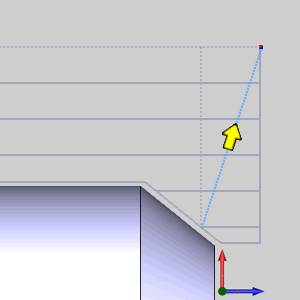

Approach
Default Rapid Approach - uses the default configuration for rapid moves based on the Feature Type and Region.
OD Clearance - creates a rapid move from its previous location to the OD clearance plane at the same Z position as the start of the toolpath.

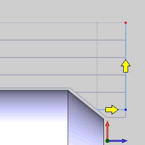

ID Clearance - creates a rapid move from its previous location to the corner of the Face and ID clearance planes. It then moves along the Id clearance plane to the Z position of the start of the toolpath, followed by a vertical move to the toolpath.
Face Clearance - creates a rapid move from its previous location to the corner of the Face clearance planes at the same X position as the start of the toolpath.

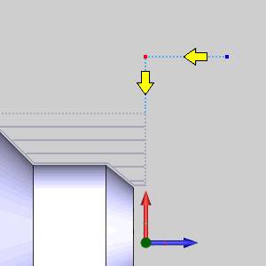

Rapid to Defined Point X-Z - creates a rapid move from the previous location to the location specified here. It will then move in X and then Z to the start of the toolpath.

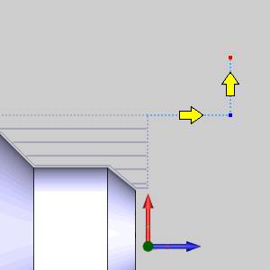

Rapid to Defined Point Z-X - creates a rapid move from the previous location to the location specified here. It will then move in Z and then X to the start of the toolpath.
Rapid to Defined Point XZ - creates a rapid move from the previous location to the location specified here. It will then move in X and Z at the same time to the start of the toolpath.

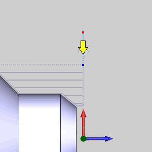

Rapid to Defined Point X Only - creates a rapid move from the previous location to the specified X location. The location in Z will be set by the start of the toolpath. It will then move in X to meet the start of the toolpath.

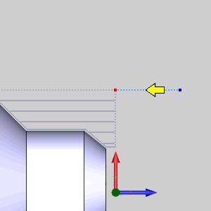

Rapid to Defined Point Z Only - creates a rapid move from the previous location to the specified Z location. The location in X will be set by the start of the toolpath. It will then move in Z to meet the start of the toolpath.

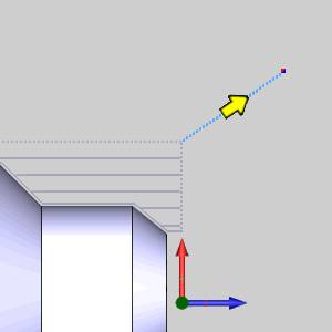

Direct- creates a rapid move, from the previous position to the start of the toolpath.

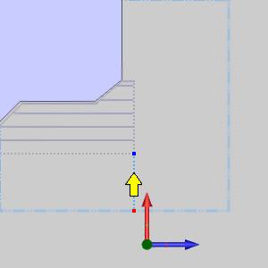

Exit
Default Rapid On Exit - uses the default configuration for rapid moves based on the operation type.
Rapid on Exit to Tool Home X-Z - creates a rapid move in the X-axis first and then a rapid move in the Z-axis.
Rapid on Exit to Tool Home Z-X - creates a rapid move in the Z-axis first and then a rapid move in the X-axis.
Rapid on Exit to Tool Home ZX - creates a rapid move in both the X-axis and the Z-axis on the same line.
Rapid on Exit to Cycle Start X-Z - creates a rapid move to the X-axis position issued at the beginning of the cycle and then a second move to the Z-axis position issued at the beginning of the cycle.
Rapid on Exit to Cycle Start Z-X - creates a rapid move to the Z-axis position issued at the beginning of the cycle and then a second move to the X-axis position issued at the beginning of the cycle.
Rapid on Exit to Cycle Start ZX - creates a rapid move to the X-axis and the Z-axis positions issued at the beginning of the cycle.
Rapid to Defined Point X-Z - creates a rapid move in the X-axis to the defined point and then a rapid move in the Z-axis to the defined point.
Rapid to Defined Point Z-X - creates a rapid move in the Z-axis to the defined point and then a rapid move in the X-axis to the defined point.
Rapid to Defined Point ZX - creates a rapid move in the X-axis and the Z-axis to the defined point.
No Rapid on Exit - does not generate a rapid move after the completion of the operation.
