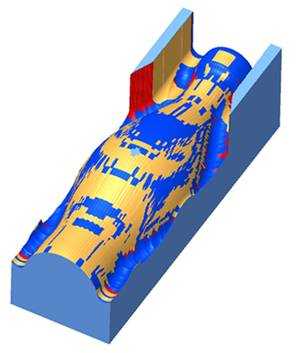

The following picture shows a machining of a bottle. The material is colorized after the different tools being used. As you can see there are four different tools (or operations) used for the machining.

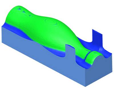

The following picture shows a machining of a bottle. The colorization is from green (min. material left) to blue (max. material left). You see two significant results:
Due to the step over of the machining big cusps are left on the machining surface (left side).
The tool used was too big to get into the area between the bottle neck and bottle head. A rest machining is necessary.

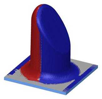

The following picture shows a machining of a male formed part. The colorization is red (for plunging) and blue (for retracting). The machining is OneWay, starting from one side going to the other side.

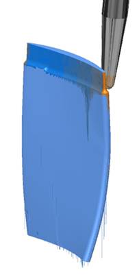

The following picture shows a machining of a turbine blade. The colorization is from blue (low rotation speed) to orange (high rotation speed). You see that especially in the small corner radius the orientation speed is high. The quality in this area could suffer.

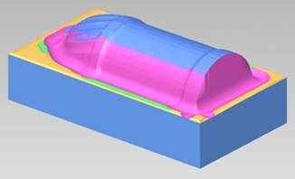

The following picture shows a machining of a bottle. You see that the toolpath length varies in certain areas. The toolpath points are not equally distributed.

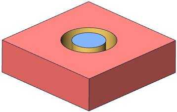

The following picture shows the part after machining. It is divided into two parts now.
