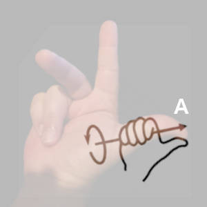

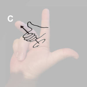

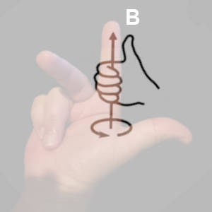

As seen in the image below, standard axes of rotation are also defined by the fingers of the Right-Hand Rule.
| A,B,C |

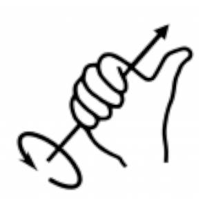

Unlike the X, Y, Z axes, the A, B, C, are axes of rotation, so another thing we may want to know is the positive direction of rotation. This can also be found by using your right hand and aligning your thumb to any of the positive axis directions and looking at the way your fingers would be wrapped around that axis.
Warning: Machine tool manufacturers do not always build their machines to align with the standard direction of rotation for positive and negative directions of rotation so make sure to keep that in mind!
