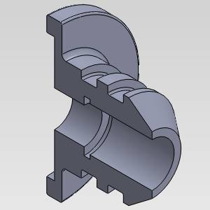

This tutorial is designed to highlight some of the key areas of the lathe module. In this example, we will be working on both the OD, and the ID. Operations will include Turning, Grooving, and Threading.

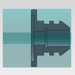

The first page of the Stock Wizard allows you to define a Workpiece for the Turning Job and the subsequent pages handle shape, size and clearances. In this example, we will not define a Workpiece, but will define the shape, size and clearances for our stock. Once the stock has been defined you can adjust the visibility of the stock.
  2. In the Stock Type page, leave the selection on Cylindrical and click inside of the Stock Coordinate System.
  3. Select Coordinate System 1 from the Flyout Feature Manager Design Tree.
    The Stock is now associated with Coordinate System 1.

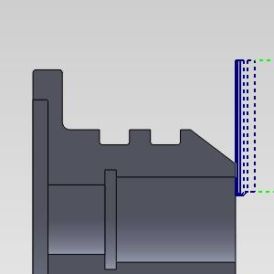

For most every Turning Job, you will need to face off the stock. By selecting a Lathe End Face feature, we will automatically create toolpath up to the machine zero without the need to select geometry. The only time geometry will need to be selected for the Lathe End Face feature is if the desired toolpath needs to end before, or, continue beyond the machine zero.
Add the Feature
  1. In the CAM Tree, right-click Machine Setup - 1 and select Lathe End Face.
    The Lathe End Face feature launches with the Geometry Selection page active. Since our target geometry is already at the machine zero, we do not need to select geometry.
  2. Click Next>> to continue to the Feature page.

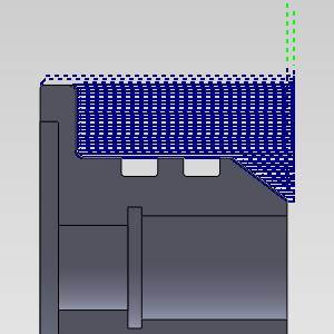

  1. Select Rough / Finish in the Machining Strategy section of the Machining Strategy page to assign a Rough and Basic Finish operation to the feature.
  2. Select Parameters.
Adjust Parameters
  1. Adjust the Z value of the Finish Allowance to 0.0010.
  4. Select Finish.
Tip: In this case, our stock has already been faced off. In order to avoid unnecessary feed movement, we use the Trim to Stock option to set trim the toolpath to the Operation Stock.

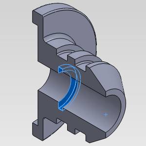

Part 5) Grooving the OD
In this case, we have two grooves that need to be completed on the OD of the part and one groove on the ID. Right now we will focus on the two OD grooves.
    The Lathe Wizard launches.

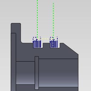

  2. Click Select Geometry.
  3. In the graphics area:
    1. Click on each one of the 5 surfaces comprising a single groove.
    2.  Do this for the other groove as well.
      Both grooves are highlighted.

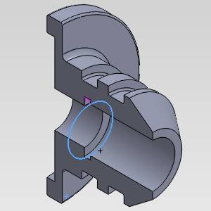

Part 6) Boring the ID

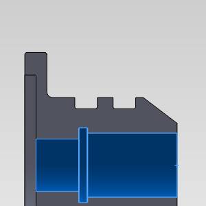

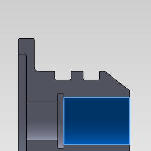

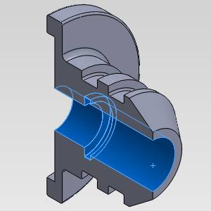

    1. Select each of the ID surfaces of the part, including the three internal groove surfaces.
    2. Press confirm the geometry selection.
Set Feature Settings
  1. In the Feature page under Material Approach, set the Rapid Plane to 0.0500.
  2. Under Feature Parameters, select ID from the Feature Type list to set the orientation of the feature.
  3. Under Undercut, select the Remove Primary Undercut check box so that our rough does not try to complete the ID groove feature.
  4. Select the check box for Extension and enter a value of 0.4500 into the End Distance box.
  5. Select Rough.

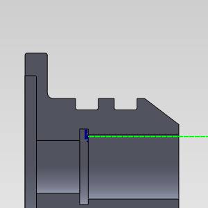

  1. In the Parameters page, select the check box for Rough Allowance and adjust the Z value to 0.0010.
  1. Select Leads.
  2. Click Compute.

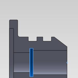

Part 7) Grooving the ID

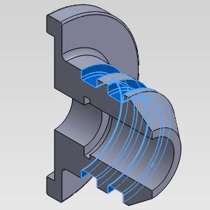

    1. Select each of the three ID groove surfaces of the part.
  1. In the Feature page, under Material Approach, set the Rapid Plane to 0.0500.
  3. Under Constraints, select Custom and then click Pick since the material has already been removed for a portion of this geometry, we can change where the toolpath begins.
  4. Highlight the top edge of the smaller wall of the groove, and left-click.
  5. Confirm the geometry selection.
    The Lathe Wizard returns.
  6. Select Groove.

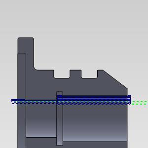

  1. In the Feature page, under Feature Parameters select ID from the Feature Type list.
    1. In the Start Distance box enter a value of 0.3750.
    2. In the End Distance box enter a value of 0.0300.

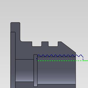

  3. Select Thread.
Select a Tool
  1. Click Tool Crib.
  3. Select tool number 505 to highlight the 60 DEG - LAY DOWN - ID THREAD .IC  tool.
  4. click OK.
  5. In the Tool Crib:
    2. Click OK.
  6. Select Parameters.
Set Parameters and Compute

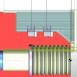

  1. Under Parameters, set Threads Per Unit to 5.0000.
  2. Select the check box for Override and set Thread Height to 0.1190.
Important: The Thread Height that is calculated in BobCAD-CAM is the theoretical sharp height. Depending on the thread being cut, you may need to adjust this value.
  1. Click Compute.
