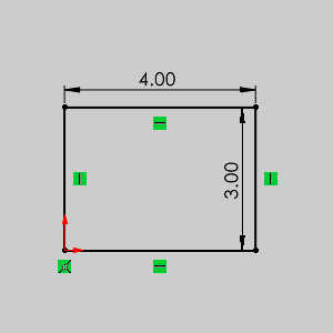

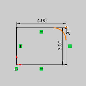

Part 2) Create the Rectangle
  1. Right-click the Front Plane and select Sketch.
  2. Choose Tools > Sketch Entities > Corner Rectangle.
  3. Starting at the origin, create a rectangle with values X = 4 and Y = 3 and click OK.

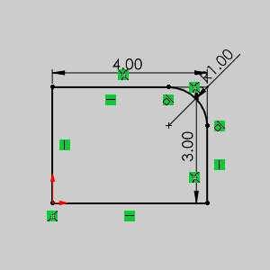

Part 3) Create the Fillet
  1. Choose Tools > Sketch Tools > Fillet...
  2. Set the Parameters to 1.0000.
  3. Select the Vertex at the top-right and click OK.
  4. Exit the sketch.

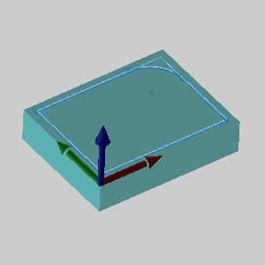

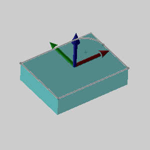

Part 5) Create the Stock
  1. With Rectangular selected, the software automatically creates a bounding stock for the text in the graphics area.
  2. In the Offset group, add a 0.2500 offset for -X, +X, -Y, and +Y.
  3. Click to go to the Machine Setup.

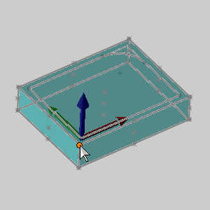

Part 6) Set the Machine Setup and Work Offset
  1. Select the following vertex as the origin.
  2. In the Work Offset group, set the Z value to .000.

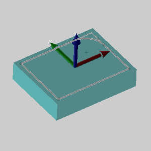

Part 7) Create the Feature
  1. In the CAM Tree, right-click Machine Setup, and click Mill V-Carve.
  2. In the Mill V-Carve Wizard, click the Select Geometry button.
    The Mill V-Carve Wizard disappears, allowing you to select geometry from the graphics area.
  3. In the FeatureManager Design Tree, select the sketch.
    The Mill V-Carve Wizard returns.
  5. Click Next>> to go the Feature page.
  6. In the Feature Parameters group, change the Total Depth to .
  7. Click Next>> to go the Machining Strategy page.
  8. In the Tree on the left of the wizard, click Machining Strategy to jump to that page.
  9. Under Available Operations, with Tapered Pocketing selected, click the left arrow button, , to add the operation to the Current Operations list.
  10. Under Current Operations, click the up arrow button, , to move the Tapered Pocketing operation to the top of the list.
  11. Click Next>> to update the tree with the new operations.

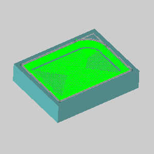

Part 8) Set the Roughing Tool
  1. Click Next >> again to move to the tool page.
  2. Change the Diameter value to , and press Tab to update the value.
    The system automatically selects a tool from the Tool Library (after checking the Tool Crib).
Part 9) Set the Parameters
  1. Click Next>> to go to the Parameters page.
  2. Notice the Pocket Depth is already defined.
  3. Change the Depth of Cut value to .
  4. Update the Endmill Cutter Width % value to 33.
  5. Click Next>>.

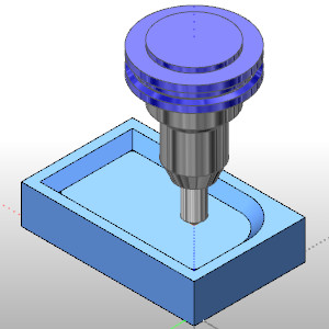

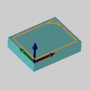

Part 10) Set the Finishing Tool
  1. Confirm the default inch Diameter V-Tool is selected, and click Next>>.
Part 11) Set the Finishing Parameters
  1. Under Depth Options, change the V-Tool Depth of Cut value to .
  2. Change the V-Tool Roughing Stepover value to .
Note: Notice the V-Tool Cleanup Parameters. Because we are using a Tapered Pocketing operation, we can set the stepover to perform a cleanup path in the corners of the pocket using the V-tool.
  1. Change the V-Tool Cleanup Stepover value to .
  2. At the bottom of the wizard, click Compute.
  3. To view the toolpath simulation, right-click Milling Job and click Simulation. For more information on using simulation, view Getting Started with Simulation.
