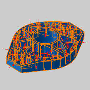

Part 5) Surface paths
  3. Select the model.

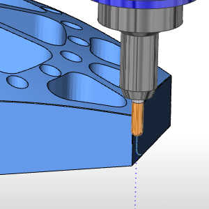

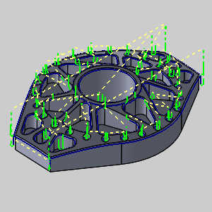

Part 7) Simulation
    Notice the operation is also trying to do the four vertical edges as well.

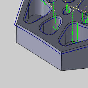

Part 10) Edit the feature
  1. Notice the toolpath on the corners of the part.

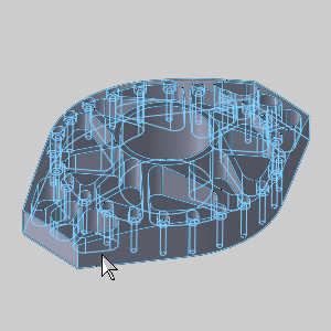

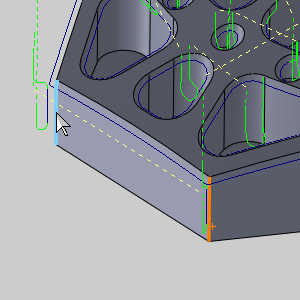

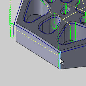

  4. In the Geometry input group of the Surface paths tab, click the ellipses button next to Exclude edges.

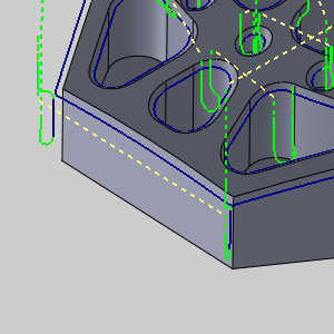

  5. Select the corner edges.
    Repeat this on the other side of the part.
  6. Click Compute.
