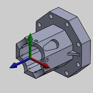

Deburr 4+1 Axis Example
If you are connected to the Internet, the part file for this example can be downloaded automatically by clicking the following link: Deburr 4+1Axis Example.sldprt

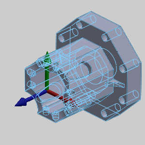

In the example file provided, the Tool Crib is already equipped with the necessary tools and the stock and Machine Setup are already defined. The part is simulated using the BC_Hermie_C20U machine.
Part 1) Add the Feature

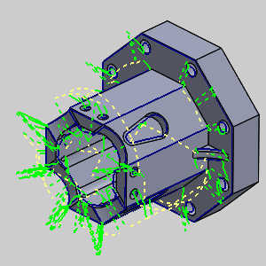

Part 5) Surface paths
  3. Select the model.
Part 6) Tool axis control

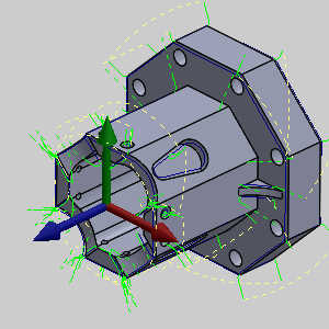

  3. Click Compute.

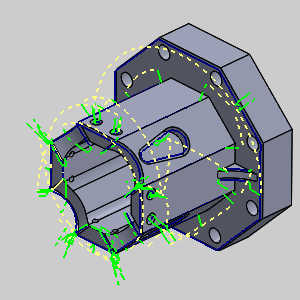

Part 7) Editing the feature

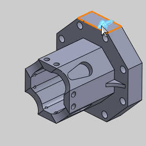

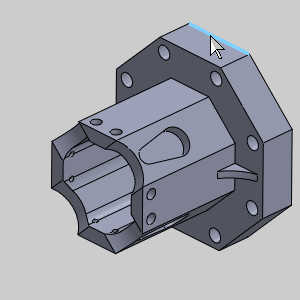

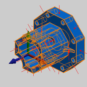

    The Mill Multiaxis Wizard disappears and the Re/Select Geometry dialog opens allowing you to select edges to avoid cutting.
    With the edge highlighted, right-click and select Select Loop.

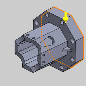

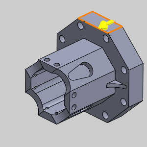

  5. Click the arrow to flip the loop selection.

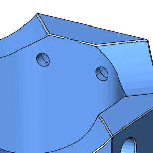

  6. Select the edge along the outer diameter of the part as seen in the image below.
  7. Repeat this for the remaining edges.
  8. Click OK.
  9. Click Compute.

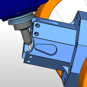

Part 8) Simulation
Part 9) Edit the feature
  5. Click Compute.
Part 10) Simulation
