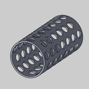

If you are connected to the Internet, the part file for this example can be downloaded automatically by clicking the following link: Deburr 4Axis Example.sldprt
In the example file provided, the Tool Crib is already equipped with the necessary tools and the stock and Machine Setup are already defined. The part is simulated using the BC_4x_Mill machine.

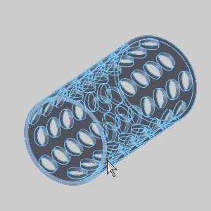

Part 5) Surface paths
  3. Select the model.

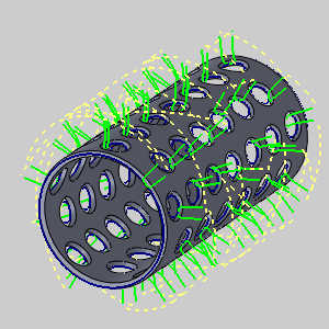

Part 6) Tool axis control
  2. In the Tilting group, set the Machining type to 4 axis (rotary).
  3. Click the ellipses button next to Axis.
    The Line dialog appears.
  4. Set the Direction to X.
  5. Click OK.
    The Line dialog disappears.
  6. Click Compute.

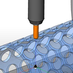

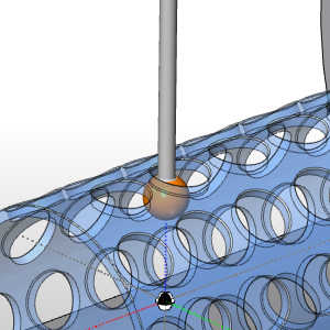

Part 7) Simulation
    Notice that while we are able to deburr the outside of the part, the inner edges remain untouched.
Part 8) Edit the tool
  2. In the tree on the left of the wizard, click Finish.
  3. In the Tool page, click Tool Crib.
    The Tool Crib dialog appears.

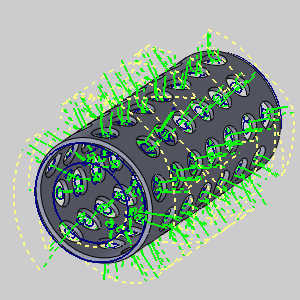

  4. Click LOLLIPOP and select the tool.
  5. Click Compute.

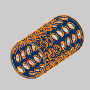

    Notice the additional places toolpath has automatically been placed now that we are using a tool capable of undercuts.
Part 9) Simulation
    Notice the undercuts now being completed by the operation.
