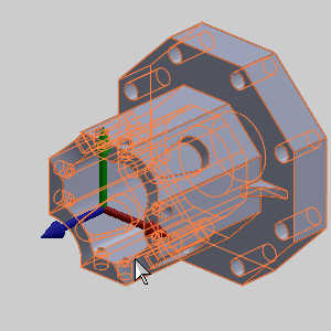

  3. Select the model.

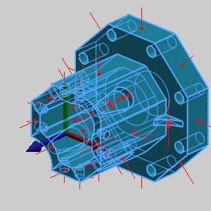

  5. In the Geometry input group, click the ellipses button next to Exclude Edges.
    The Mill Multiaxis Wizard disappears and the Re/Select Geometry dialog opens allowing you to select edges to avoid cutting.

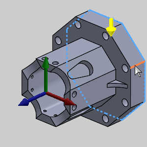

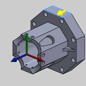

  6. Hover over the back edge as seen in the image below.
    With the edge highlighted, right-click and select Select Loop.

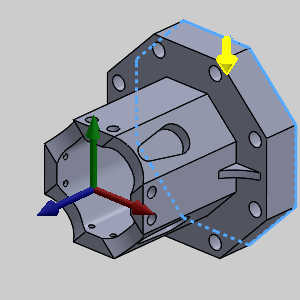

  7. Click the arrow to flip the loop selection.

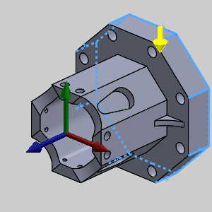

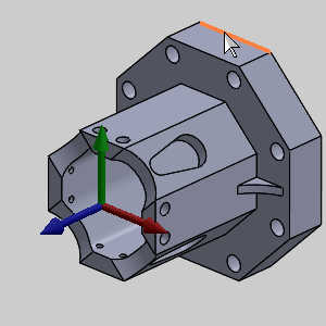

  8. Select the edge along the outer diameter of the part as seen in the image below.
  9. Repeat this for the remaining edges.

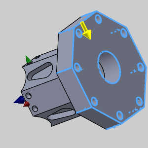

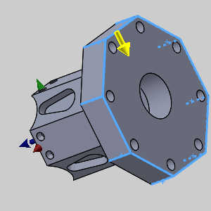

  10. Rotate the part and select the edges on the back.
    With these edge selected, we will avoid the cutting the jaws holding the part in place.
  11. Click OK.

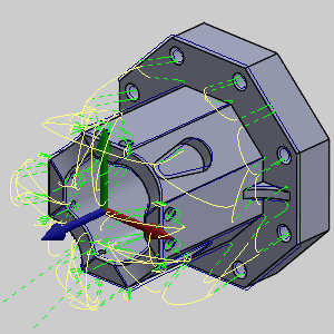

  12. In the Surface Quality group, set the Cut tolerance to 0.001.
Part 6) Link page
  1. Click the Link tab to move to that page.
  2. In the Clearance area group, set the Type to Automatic.
  3. In the Links group, set the Type to Clearance blend spline.

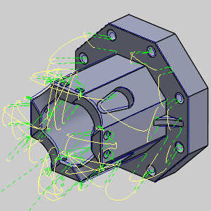

  4. Click Compute.

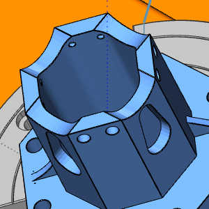

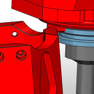

  5. Click Play to view the current operation.
    Notice the crash.
    We will need to adjust the allowable angle of tool to correct this.

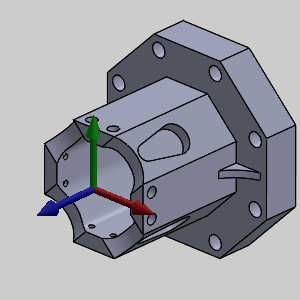

    Notice the slight tilt of the toolpath now.
