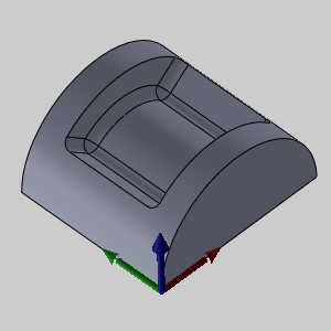

In the example file provided, the Tool Crib is already equipped with the necessary tools, the stock and Machine Setup are already defined, and a roughing operation has prepped the part for the finishing operations. The part is simulated using the BC_Hermie_C20U machine.

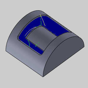

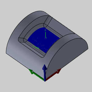

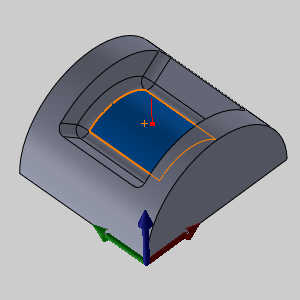

  5. Click the ellipses button next to Floor surfaces.
    The Re/Select Geometry dialog appears.
  6. Select the bottom of the part as seen in the image below.
  7. Click OK.

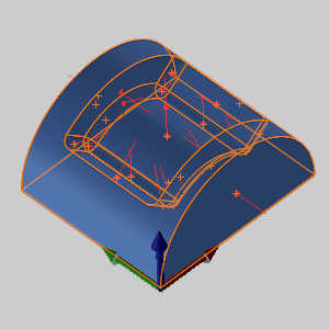

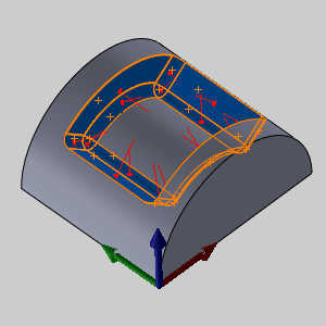

  8. Click the ellipses button next to Wall surfaces.
  9. Select the walls of the part as seen in the image below.
  10. Click OK.

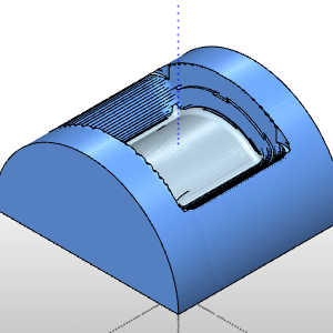

Part 7) Simulation
  2. Click Play to view the Roughing operation in simulation.
    This will allow you to ensure this operation is free of collisions.

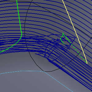

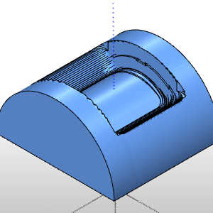

    Zoom into the corner and notice the toolpath.
Part 3) Simulation
    In this case we can see the wall is finished nicely without gouges.
    But we can see wild swings in the corners while machining the fillet:

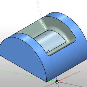

Part 5) Simulation
