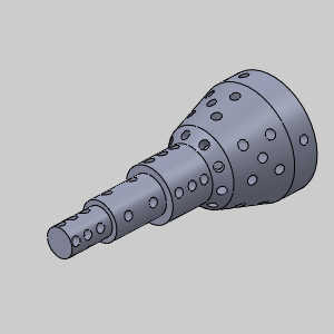

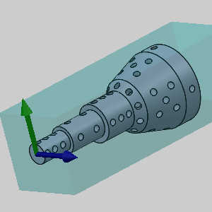

In the example file provided, the Tool Crib is already equipped with the necessary tools and the stock and Machine Setup are already defined. The part is simulated using the BC_Porting_4x_HeadTable_Rotary_Only machine.

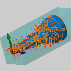

Part 6) Part definition
  1. Click on the Part definition tab to jump to define the geometry.
  2. Next to Part, click the drop down on Turn profile and set it to Part surface.
    This will allow us to select the solid as geometry rather than using a wireframe profile.
  3. Click the ellipses button next to Part surface.
    The Mill Multiaxis wizard disappears and the Re/Select Geometry dialog appears.

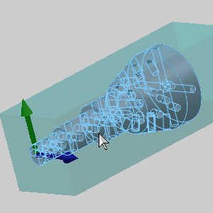

  4. Select the check box for Select whole bodies.
  5. Select the model.
  6. Click OK.
  7. Set the Stock to leave value to 0.05.
  8. Click the Axis of rotation button.
    The Rotation axis dialog appears.
  9. By default the By base point and direction option is selected.
    Set the Direction to X, and click OK.
    The dialog disappears.

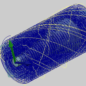

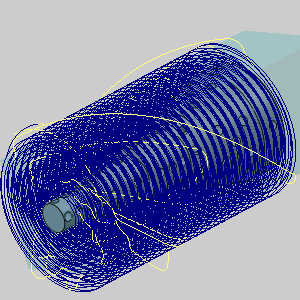

  10. Click Compute.
    Notice we are machining all the way to the back of the stock.
    We will update this in the next part.

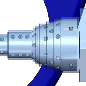

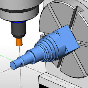

Part 8) Simulation
  3. Set the Stock to Transparent and the Workpiece to Show.
    Notice we are machining to the end of the part but do not collide with the chuck.
    This was adjusted by limiting our machining area.
  4. To close simulation, in the BobCAM menu, click Exit Simulation.

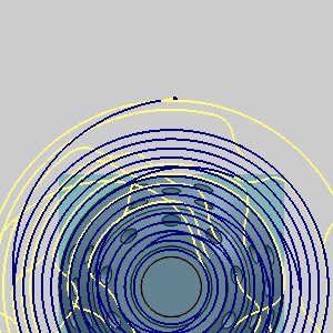

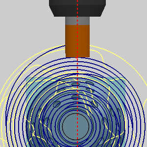

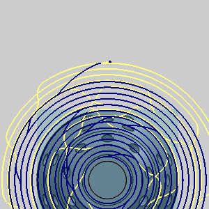

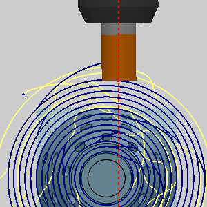

  3. In the Axis offset group, set the Tool diameter (%) to 10.
    This will move the tool closer inline with the axis of rotation.
Tool diameter (%) : 40 Tool diameter (%) : 10
  1. In the Non-cutting moves group, update the Ramp angle to 20.
    This adjusts the angle of the entry move.
Ramp angle : 5 Ramp angle : 20
