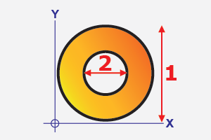

Ring (Shape 2)
1 - the outside diameter.
2 - the inside diameter.
NOTE:      P1 must be greater than P2. If P2 is zero then no center hole is created.

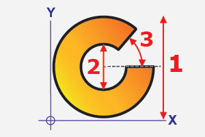

Cut Ring (Shape 3)
3 - the angle range of the slot measured counterclockwise starting at 0.00 degrees.
TIP:   If using a large value for P3, it may be better to use Ring Segment. The Ring Segment uses the arc center as the origin and it is calculated with a smaller bounding box than Cut Ring.

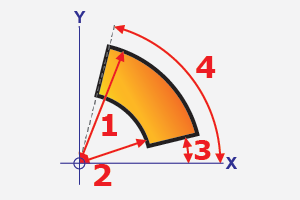

Ring Segment (Shape 4)
1 - the outer radius.
2 - the inner radius.
3 - the starting angle measured from zero degrees or the X-axis of the shape origin.
4 - the ending angle measured from zero degrees or the X-axis of the shape origin.
NOTE:      The angles for P3 and P4 are positive or negative values between 0.00 and 360.00 degrees.

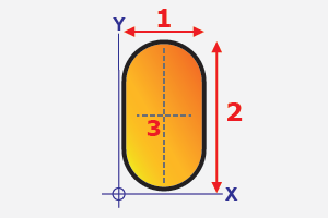

Slot (Shape 5)
1 - the length or X-axis dimension from the shape origin. This value should be less than P2.
2 - the width or Y-axis dimension from the shape origin. This value should be greater than P1.
3 - the rotation angle about the center of the slot. This is used to define the orientation of the slot. A value of 0.00 degrees creates a vertical slot and a value of 90.00 degrees creates a horizontal slot.
TIP:   While P3 rotates the slot from the center, you can use the Rotation Angle parameter to rotate the slot about the origin (lower-left corner) of the shape.

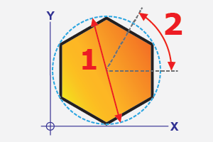

Inner Polygon (Shape 8)
1 - the inside diameter of the polygon. All sides are created tangent to this diameter, so this is the distance between any two parallel sides.
2 - is the amount of rotation in degrees around the shape center. The rotation angle is applied counterclockwise from zero degrees (3 o'clock).
Number of Sides - is the number of sides for the polygon, which must be greater than two.
TIP:   One side of the polygon is always created parallel to the Y-axis.

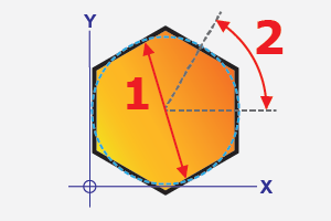

Outer Polygon (Shape 9)
1 - the outside diameter of the polygon. All sides are created within this diameter (the intersection of any two sides meet this diameter).
Number of Sides - the number of sides for the polygon, which must be greater than two.

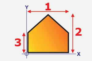

Quad Sided Plate (Shape 11)
1 - the total length or X-axis dimension from the shape origin.
2 - the length or X-axis dimension of the top side.
3 - the top offset or the Y-axis dimension from the top boundary to the upper-left corner as a positive value. This value must be less than the total width (P4) and can be set to zero.
4 - the total width or Y-axis dimension from the shape origin.
5 - the right offset or the X-axis dimension from the right boundary to the upper-right corner as a positive value, which can be set to zero.

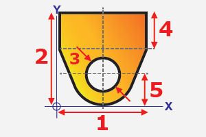

Symmetric Lug (Shape 18)
2 - the total width or Y-axis dimension from the shape origin.
3 - the diameter of the inner hole.
4 - the shoulder width or Y-axis dimension from the top of the shape to the bottom of the vertical walls.
5 - the center of the hole or Y-axis dimension from the shape origin.

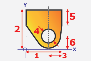

Asymmetric Lug (Shape 19)
3 - the hole center or X-axis dimension as a positive value from the right boundary (the end of P1). If you set this value to 0.00, the center of the hole is moved to the end of P1, thus changing the shape of the lug.
4 - the diameter of the inner hole.
5 - the shoulder width or Y-axis dimension as a positive value from the top of the shape to the bottom of the vertical walls.
6 - the hole center or Y-axis dimension from the shape origin. (This is also the outer radius of the lug.)

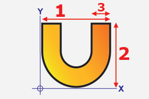

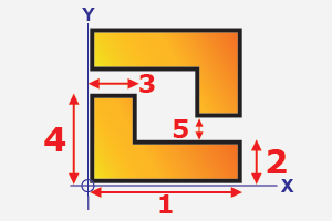

U (Shape 20)
3 - the length of the shape body.

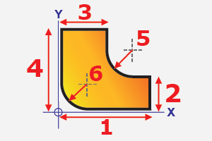

L Bracket (Shape 21)
2 - the width of the right side or Y-axis dimension from the shape origin.
3 - the length of the top side or X-axis dimension from the shape origin.
5 - the inner (upper right) radius.
6 - the outer (lower left) radius.

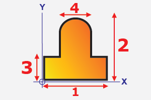

Straight Support with Tab (Shape 22)
3 - the width of the tab or Y-axis dimension from the shape origin.
4 - the length of the tab or X-axis dimension, which is automatically centered on the shape (or P1).

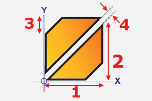

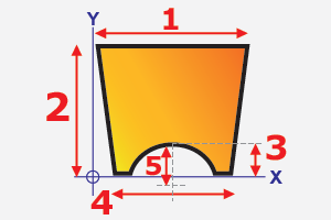

Slanted Support with Slot (Shape 25)
1 - the total length of the upper side or X-axis dimension from the shape origin.
3 - the width of the slot or Y-axis dimension from the shape origin.
4 - the length of the slot or X-axis dimension, which is automatically centered on the shape (or P1).
5 - the total length of the lower side or X-axis dimension, which is automatically centered on the shape (or P1).

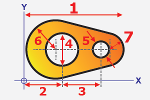

Lollipop (Shape 32)
1 - the distance from the center hole (or half of P3) to the right boundary of the shape as an X-axis dimension.
2 - the thickness or Y-axis dimension for the right side of the shape (tab).
3 - the total width or Y-axis dimension from the origin. This is the diameter of the left side of the shape.
4 - the center hole diameter, which is automatically centered in the diameter (or P3).
5 - the corner radius between the tab and the diameter (the transition radius).

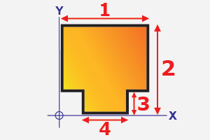

3 - the length or X-axis dimension from the shape origin.
5 - the vertical distance or Y-axis dimension between brackets (the gap dimension).

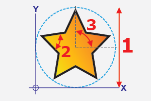

Star (Shape 37)
1 - the diameter used to create the star. The outer points of the star meet this diameter.
2 - the angle range of the star corners.
3 - is the amount of rotation in degrees around the shape center. The rotation angle is applied counterclockwise from zero degrees (3 o'clock). With a value of zero, one of the corners points to zero degrees. A value of 90.00 degrees moves this corner to the 12 o'clock position.
Number of Corners - the number of corners for the star.

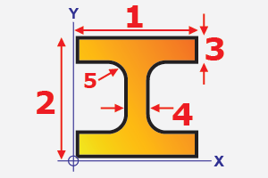

I Beam (Shape 38)
3 - the vertical width or Y-axis dimension of both horizontal sections.
4 - the horizontal length or X-axis dimension of the center section.
5 - the corner radius between the horizontal and vertical sections (the transition radius).

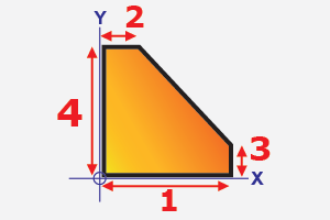

Angle Triangle (Shape 39)
2 - the internal angle of the lower-left corner.
3 - the internal angle of the lower-right corner.
