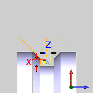

The Lead-in is an additional move prior to the initial cut into the material. The Lead-in allows you to specify how the cut is approached.
Parallel - creates a lead into the material that is parallel with the toolpath move it is preceding.
Perpendicular - creates a lead into the material that is perpendicular to the toolpath move it is preceding.
Horizontal - creates a lead into the material that is parallel to the center of rotation.
Vertical - creates a lead into the material that is perpendicular to the center rotation.
Angle - creates a lead into the material that is at a 45 degree angle.
Custom - creates a lead into the material that is dictated by the values entered in the Lead-in Z, and Lead-in X boxes.
Lead-in Z - sets the distance and direction of travel, in the Z-axis, for the approach into the toolpath
Lead-in X - sets the distance and direction of travel, in the X-axis, for the approach into the toolpath

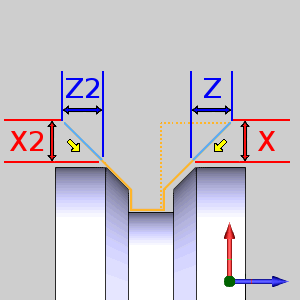

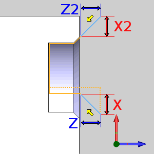

Override Z2/X2 - When the Force
Down Cutting pattern is in use, there are actually two lead-ins to
the feature. By default, these values are adjusted so the one side
is a mirror of the other. Selecting this option will allow the Lead-in
Z2, and Lead-in X2 variables to be adjusted by the user.
Lead-in Z2 - sets the distance and direction of travel, in the Z-axis, for the other approach into the toolpath
Lead-in X2 - sets the distance and direction of travel, in the X-axis, for the other approach into the toolpath
