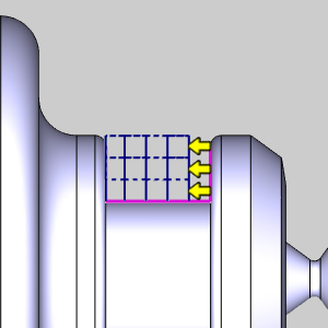

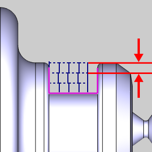

The Multiple Depths group allows you to break the total groove depth into steps rather than just one full depth cut or pecked cut.
Depth of Cut - allows you to set the spacing between depth passes.
Processing - allows you to handle instances where the selected geometry causes the toolpath to be broken along a number of passes. This will allow you to decide how the tool will move between the separated areas of toolpath.

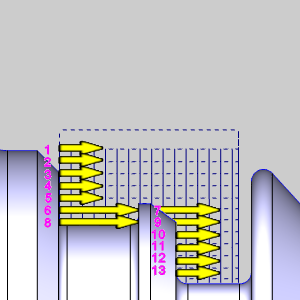

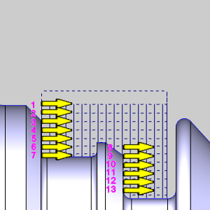

RadioButtonSelected.png By Area - will complete all depth passes on whole area before moving to next.

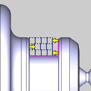

RadioButtonClear.png By Level - will cut all areas of the part to the current pass depth before beginning the next.
By Area
By Level

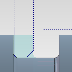

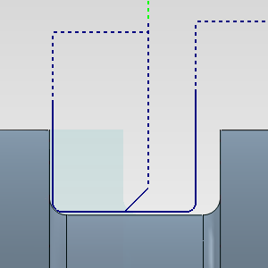

Bounds
CheckBoxCleared.png Trim to Stock -  Selecting this option will trim away toolpath that extends beyond the Operation Stock.
Trim to Stock off
Trim to Stock on
