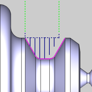

Stepover - sets the spacing between toolpath passes.

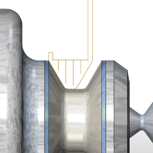

CheckBoxCleared.png Rough Allowance -  Selecting this option will create a pass before the final pass to act as a semi-finish. The spacing of the semi-finish pass will be dictated by the values entered in the Z and X boxes.
Semifinish Pattern - Once a Rough Allowance has been selected, the Semifinish Pattern will allow you to select between a one directional semifinish, or a semifinish that forces a downward cut.

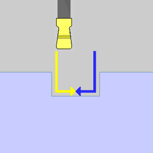

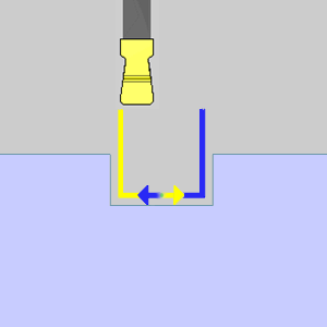

RadioButtonSelected.png Force Down Cutting - selecting this option will force the semifinish to be cut from each side of the groove one at a time, each in a downward direction, to the middle of the groove. Adding an overlap will set each pass to go past the center of the groove half the specified amount.
Overlap - sets the total distance between the two passes exits, not including any leads that are uses.

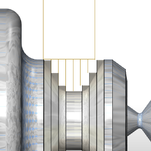

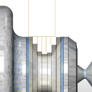

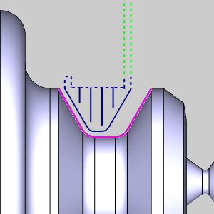

Force Down Cutting Off
Force Down Cutting On
With Overlap
RadioButtonClear.png Basic Finish - sets the semifinish pass to one single direction.
No Allowance
Finish Allowance
Rough & Finish
No Allowance Simulation
Finish Allowance Simulation
Rough & Finish  Simulation

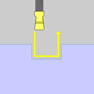

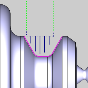

CheckBoxCleared.png Multiple Depths
The Multiple Depths group allows you to break the total groove depth into steps rather than just one full depth cut or pecked cut.
Depth of Cut - allows you to set the spacing between depth passes.

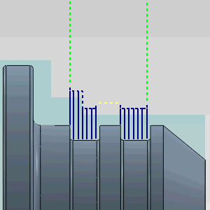

CheckBoxCleared.png Trim to Stock -  Selecting this option will trim away toolpath that extends beyond the Operation Stock.
Trim to Stock off
Trim to Stock on
