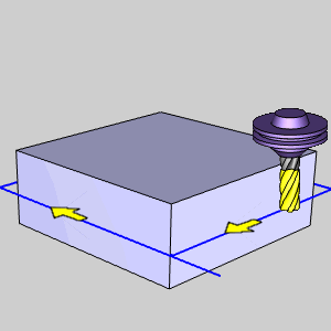

System Compensation
With this option On, the system offsets the geometry by the tool radius. With this option Off, you should use Machine Compensation.
These options only effect the output in the posted code.
Off - no cutter compensation codes are output in the posted program.
Comp Left (G41) - the toolpath of the operation represents the center of the cutter. The post processed code includes the command for cutter compensation to the left of the contour.
Comp Right (G42) - the toolpath of the operation represents the center of the cutter. The post processed code includes the command for cutter compensation to the right of the contour.

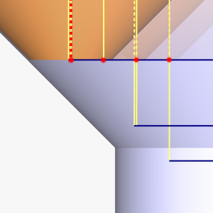

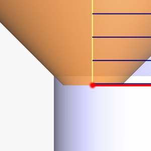

Cutter Position - sets
the distance away from the center of the toolpath to begin the cut,
in order to use a chamfer tool that does not have flutes that extend
all the way to the tip.
Small Diameter - sets the width of the bottom of the chamfer tool when Flat Bottom Tool is selected.

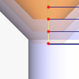

Multiple Steps - the
Total Depth and Depth of Cut values are used to generate the number
of equal cuts used to process the profile operation. This enables
the following four options.
Depth
of Cut - When using Multiple Steps, this is the depth
at which all passes, prior to the final depth, will be taken.
Click
here to see an example.

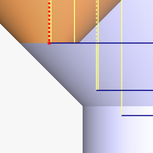

Stepover -
will add side roughing steps to each Depth of Cut prior to
the final depth. The value entered will set the step over
amount which all steps, prior to the final step, will use.
Click

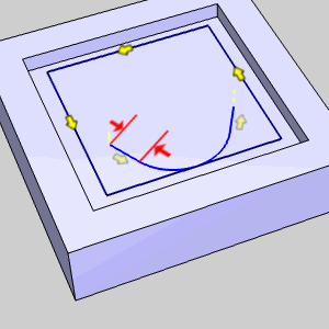

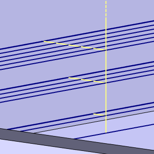

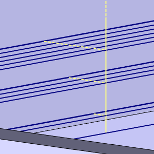

Minimize
Retracts - Selecting the Minimize Retract check box helps
prevent the tool from lifting back up to the rapid height before
the next cut.
Link with Rapid - will connect the passes with a rapid move at depth. With this option cleared, the link will be a feed move.
Click here to see an example of Minimize Retracts.
IMPORTANT: Normally, at the end of a pass, the tool retracts to the rapid plane, moves to the X, Y position of the next cut, rapids down to the feed plane, feeds to the proper depth, then starts the next pass. Minimize Retracts will help to eliminate moves back to the rapid plane between passes with a few exceptions: If the direct link intersects with any part of the toolpath chain, the toolpath will go to the rapid plane between passes. If the direct link is on the opposite side of the offset direction, the toolpath will go to the rapid plane between passes. When no offset direction is set by system or machine compensation, left side compensation is assumed by the system.

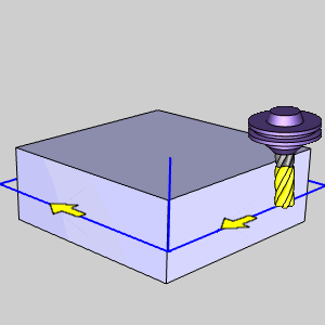

Vertical - generates a plunge feed move into the feature.
IMPORTANT: The Vertical Lead-in type is not actually a lead-in as it only creates a plunge move into the feature. Most machine controllers cannot apply compensation commands to a vertical plunge (Z-axis) move. (G41/G42 are not output when using the Vertical Lead-in.)
Parallel - generates a linear feed move into the feature parallel to the toolpath using the specified length.
Length - sets the length of the lead-in from the feature.
Right Angle - generates a linear feed at a right angle to the toolpath using the specified length.

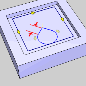

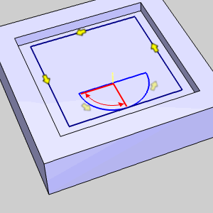

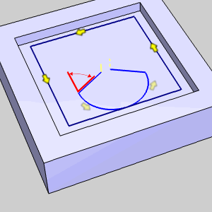

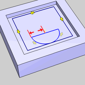

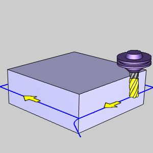

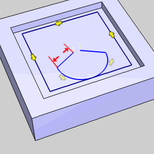

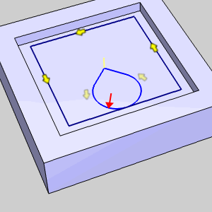

Circular - creates a linear move followed by an arc sweep into the start of the feature. You have complete control over both the line move and the arc move using the following settings.
The three previous options all provide the following settings to define the lead-in.
Line
Arc

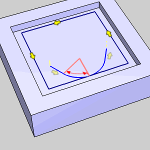

Blend - generates a linear move and then an arc move into the feature. This lead type can be used to lead-in and lead-out of the feature from the same point. The blend lead type creates a tangent path into the feature.

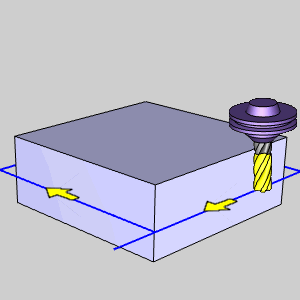

Overlap Amount - sets the length of overlap between the start point and end point of the toolpath to change the lead-in and lead-out locations.

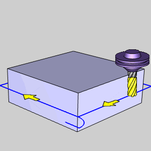

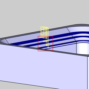

Sharp - creates a sharp corner.
Round - creates a round corner.
Loop Radius - cuts a corner using a loop of a specific radius.
% - changes the Radius box value from a specific radius of the loop to a percentage of the tool diameter.
Radius - sets the size of the loop radius.
Loop Length - cuts a corner with a loop of a specific length.
Length - sets the length of the loop.
Triangle - uses a straight line to connect the passes joining the toolpath segments around a corner.
Length - sets the length past the corner that the toolpath extends before connecting to the next segment.
Bisect Line - relieves a corner by extending a line outward from the corner and then returning to the programmed path.
Length - sets how far away from the corner the Bisect Line extends.
The four preceding Corner types also use the following settings:
Min Angle - sets the minimum included angle of a corner for which the selected Corner Type is applied.
Max Angle - sets the maximum included angle of a corner for which the selected Corner Type is applied.
