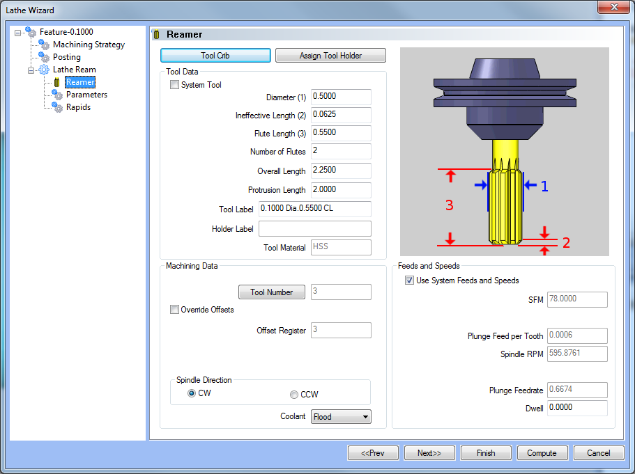

The Mill Hole Ream operation has only one tool type to choose from. It is good practice to have all the tools for the job loaded into the Tool Crib at the start of the job. By this point, those tools should already be in the Tool Crib, and the system will have pulled appropriate tools for each operation from the Tool Crib. From this tool page, you can either, choose a different tool from the Tool Crib, go into the Tool Crib to add tools from your Tool Library, or enter tool specific data manually into the Tool Data Section of the page.
Tool Data
CheckBoxSelected.png Select this check box to allow the software to automatically select tools from the Tool Crib that match the machining operation. In the case of end mills, you may alter the diameter and corner radius allowing the software to find the appropriate tool from the Tool Crib. In the case the appropriate tool sizes are not found, the software searches for a matching tool in the Tool Library. If a matching tool is found, it is added to the Tool Crib. If a matching tool is not found, a new tool is automatically created and added to the Tool Crib.
CheckBoxCleared.png When this check box is cleared, you can edit all tool information directly in the dialog box. In this case, the defined tool is added to the Tool Crib.
  • Ineffective Length (2) - sets the length of the chamfer on the tip of the tool.
  • Flute Length (3) - sets the length of the flute/cutting portion of the tool.
NOTE:      Tools and tool holders may be added or modified in the Tool Crib when it is accessed from the Milling Wizard Tool dialog box.
Machining Data
CheckBoxCleared.png Clear the Override Offsets check box to use the tool number to set the Offset Register value.
CheckBoxSelected.png Select the Override Offsets check box to allow for manual editing of the Offset Register value.
Feeds and Speeds
CheckBoxSelected.png Select this check box to automatically calculate the feeds and speeds.
CheckBoxCleared.png Clear this check box to type feeds and speeds values in the dialog box.
TIP:   While editing the feeds and speeds, changing one value automatically calculates any other associated values. For example, if you modify the SFM value, the Spindle RPM, Cutting Feedrate, and Plunge Feedrate are automatically calculated.
