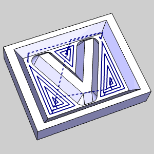

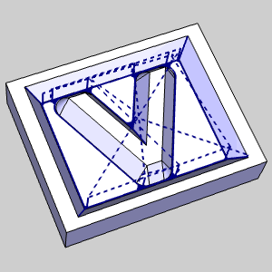

V-Carve Operation Overview
The purpose of the V-Carve operation is to create tapered walls from 2D geometry, which is especially useful for decorative purposes. Exactly how this operation is performed is dictated by the settings in the subsequent pages of the operation. Each of the pages allows you to define the  variables in order to tailor the machining process to fit your needs. Use the following links to jump to the specific topics for each available operation page:
