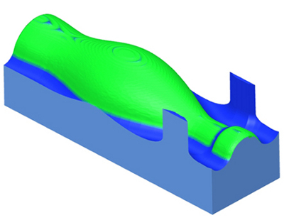

The deviation is a material offset compared to the target geometry. The color of the material changes the more or less material exists on top of the target geometry.
Main benefit
Identify the amount of the material left on the target geometry.
Identify the gouges, when too much material was removed and the target geometry is being damaged.
Identify area where a rest machining is necessary.
The following picture shows a machining of a bottle. The colorization is from green (min. material left) to blue (max. material left). You see two significant results:
Due to the step over of the machining big cusps are left on the machining surface (left side).
The tool used was too big to get into the area between the bottle neck and bottle head. A rest machining is necessary.
