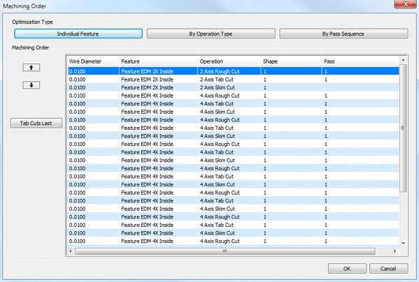

The Machining Order dialog box provides dynamic control of the posting order for all operations in a Wire EDM job. The machining order can be optimized by Individual Feature, Operation Type, or Pass Sequence as well as an option to place all tab cuts last. In addition to the optimization types, you can fully customize the order of operations for the program.

Optimization Types
Individual Feature
When selecting Individual Feature, all operations are performed for each feature before moving on to the next feature. The posting order is the same as the order in the CAM Tree. If you want to reorder the operations contained within a single feature, edit the feature, and then return to the Machining Order.
By Operation Type
The By Operation Type optimization posts the program by completing all similar operations (across all features) before moving on to the next type of operation. For example, all Rough Cut operations first, all Skim Cuts operations second, and all Tab Cut operations last.
By Pass Sequence
The By Pass Sequence optimization is similar to By Operation Type except that this option provides further control over all passes, meaning the Skim Cut operations. Skim Cut operations can contain one or more passes, which can be changed using this optimization type.
Machining Order
The machining order group contains the Operation list that shows all of the operations for the current job that are set to Post (Yes). When you select an optimization type at the top of the dialog box, the posting order is updated to that optimization type. You can then select operations in the list under Machining Order and use the Move Up and Move Down arrows to reorder the operation list.

The operation list contains columns that display the Wire Diameter, Feature name, Operation name, Shape number, and Pass number for each operation. You can click the title of each column and drag it left or right to reorder the informational columns.
