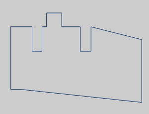

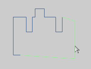

Move the mouse to any location in the graphics area to view the preview of how the entities are stretched. When you have reached the desired location, click to place the selected entity.
Drag Preview
The Result

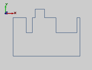

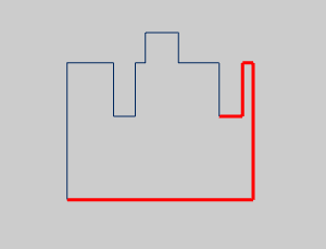

Geometry Selection
The Result
The selected entities were moved, from their current location, 0.5 units in the positive X-axis direction.

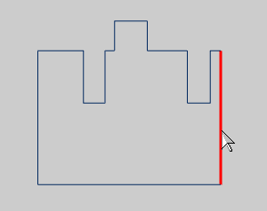

5      The next step is to make the right side the same as the left side. Select the vertical line on the right, select the two connected lines.
To confirm the selections, press Spacebar.
6      In the End group, in the X box, type 3.00, and in the Y box, type 1.00.
Click near the bottom of the vertical line on the right side, and the stretch is automatically performed.
(When you click near the bottom of the vertical line, you are selecting the snap point at the end of the line, which defines the Start point or the Move From location.)
Geometry Selection
The Result
