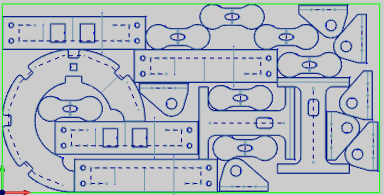

Now that the nest has been generated, we will want to make sure all the parts quantities fit on the sheet.
1      In the CAM Tree, right-click on SheetsIcon.png Sheets and select Show Summary. Here we can see we have three leftover parts. We will attempt to adjust the result to fit the others on the sheet as well.
2      Click OK at the bottom of the Nesting Summary to close it.

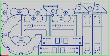

Part 10) Checking the Result
Now that the nest has been regenerated, we will want to check to see if the change we made to the Nesting Parameters has helped eliminate leftover parts.
1      In the CAM Tree, right-click on SheetsIcon.png Sheets and select Show Summary. Here we can see we have no leftover parts.
