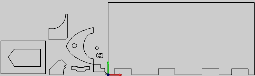

4      In the Advanced group, select the check box next to Remnant Sheet to turn on remnant sheets. Click the Remnant Sheet button to open the Remnant Sheet Parameters dialog box.
5      Take a moment to click on each one of the options from the Default Remnant Shape drop down and notice the previews for each to get an idea of the geometry each one will produce.
True Shape
Rectangular
Stepped
Clean Cut
6      Set the Default Remnant Shape to Clean Cut and click OK.

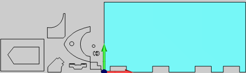

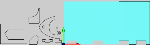

When you compute the nest the Remnant Sheet dialog box will open and you will be able to preview the possible remnant shape outputs. You can output the previewed shape to use in other jobs or adjust the preview by cancelling and adjusting the constraints in the Remnant Sheet Parameters dialog box. In this lesson we will use the current setting and output the .dxf file.
1      Notice that we have set the default Remnant Shape to Clean Cut. Take a moment to click on each option in the Remnant Shape drop down and notice the preview of the actual shapes they will produce.
True Shape
Rectangular
Stepped
Clean Cut
2      Set the shape back to Clean Cut.

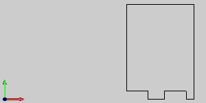

1      Open the windows file explorer again and drag the .dxf file into the BobCAD-CAM CAD window.
2      Right-click in the CAD window to access the context menu and click Select.
3      Once in selection mode, hold shift and left click the geometry to chain-select it. Once highlighted copy the geometry. This can be accomplished by either selecting Copy from the Edit menu, or by using the Ctrl+C keyboard shortcut.
4      Go back into the Remnant_Sheet.bbcd window and paste the remnant geometry into the Remnant_Geometry layer.
5      Save file.

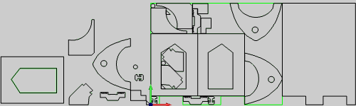

When cutting the remnant, it is important to always keep in mind that a cut will always have a width to it. To get the most of the remnant, we would always want to compensate for our tool width on the outside of our remnant. Depending on the nested result and the size of our tool, that cut may have an effect on our nested parts. In this case we will cut down the center of the line with a tool that will not interfere with the parts on the sheet. This will only have a small affect on the remnant.
