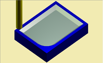

V-Carve Pocketing
The V-Carve feature type is generally used to engrave text, arcs, lines and splines in a 3-dimensional form with 3-axis tool motion, with pocketing of open spaces in the selected profiles if necessary. There are two V-Carve operation types, Tapered Pocketing and V-Carve Finishing (engraving). This example uses the both operations, one to perform the pocketing with an endmill, and the second to cut a tapered wall around the pocket.
Pocketing a shape with V-CARVE example:

  28. At the bottom of the wizard, click Compute.
  1. To view the toolpath simulation, right-click Milling Job and click Simulation. For more information on using simulation, view Getting Started with Simulation.
