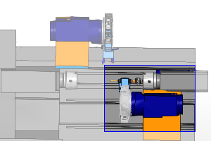

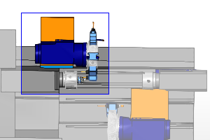

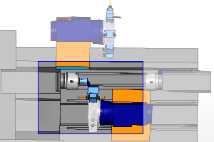

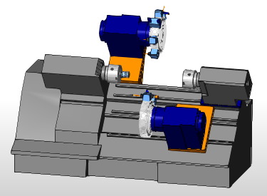

BC 2T 2S Mill Turn Machine
BC 2T 2S Submachine Naming
LT_MS = Lower Turret, Main Spindle
LT_MS = Lower Turret, Sub Spindle

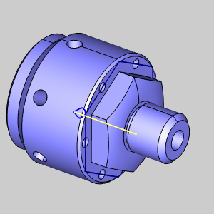

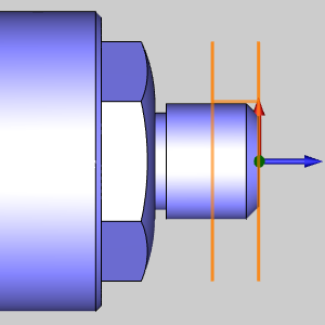

Example Part
The following images show our example part. For this tutorial, we machine the part using stock that is already cut to length. For this reason, we create our features as though the model is split into two halves: front and back. This allows us to machine the front half of the part on the main spindle before transferring the part to the sub spindle and machining the back half. This is important to understand as this determines how we create some of our features.

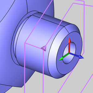

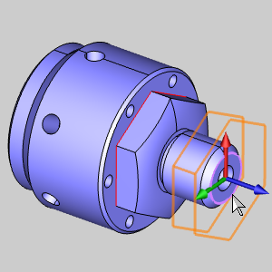

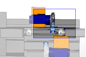

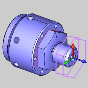

Machine Setups
For this tutorial, all features are created using one of two machine setups: one for the front side and one for the back side of the part. The following images show the location and orientation of the machining origin (work offset) for each setup.
Machine Setup 1
Machine Setup 2
The Mill Turn job, stock, and machine setups are already defined in the example file provided for this tutorial. If you would like to learn more, view the Mill Turn Job Setup Example.

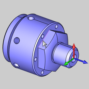

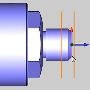

Part 3) Create a Turning Feature - Facing
Machine Setup 1

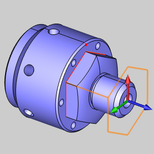

It is important to think about the machine setup (machining origin) when creating machining features for Mill Turn jobs. All of the features that we create to machine the front half of the part are created under Machine Setup 1. The machining origin for this machine setup is at the front face of the part, not the stock, (we are facing to zero).
1      Right-click Machine Setup - 1, point to Turn Features, and click Lathe Turning.
2      Click the Select Geometry button to hide the wizard and show the graphics area.
3      On the Layers tab of Layer-UCS-Post Manager, right-click the layer name Front Face, and click Show.
4      Click to select the line.
5      Click OKCheckmarkIconWhite.png to confirm the selection.
6      Click Next>> to go to the Feature settings.
Define the Feature, Machining Strategy, and Posting Settings
1      The Feature page of the wizard displays the stock settings that were automatically detected and set based on our stock geometry and work offset (machining origin) location from the (predefined) Stock Wizard and Machine Setup. The software uses these values to determine the location of the first cut, and because they are automatically set, we do not need to modify these values for this feature.
2      Click Next>> to go to the Machining Strategy.
The default template, Face Rough, doesn't need changed, but we remove our finish operation. We simply use the roughing operation to cut the face to its final depth.
3      Under Current Operations, click to select Face Basic Finish, and click DeleteOpIcon.png (Delete Operation).
4      Click Next>> to go to the Posting settings.
5      Under Posting Parameters, click the down arrow and select Canned Cycles.
TIP:   Notice the Submachine group in the Posting page of the wizard. You can always change the submachine for the feature from this location, in the event it is different from the default submachine selected in the CAM Tree.
6      Click Next>> to go to the Tool settings.

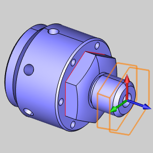

3      On the Layers tab of Layer-UCS-Post Manager, right-click the layer name Front Turn, and click Show.
In the Edit menu, point to Select Entities, and click Pick By Layer.
In the Select Layer dialog box, click Front Turn, and click OK.
4      To confirm the selection, click OKCheckmarkIconWhite.png.
5      Click Next>> twice to go to the Machining Strategy.

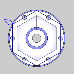

Part 5) Create a Lathe Hole Feature

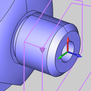

1      Right-click Machine Setup - 1, point to Turn Features, and click Lathe Hole.
2      Click Select Geometry.
Next we utilize a view option that helps us select a surface edge that is inside of the model.
3      Press the S key, to turn off the Shaded view. (Alternatively, in the View menu, click Shaded.)
4      Click to select the surface edge (at the bottom of the front hole) as shown next.
This selects the depth point for our feature and automatically sets the Total Depth from the selected geometry.
There is no need to confirm the selection, the software returns to the wizard as soon as you click the edge.

Part 7) Create a Mill 2 Axis Feature - Face/Z-axis Milling
The next feature that we create cuts the hex on the front of the part using a single operation to remove the material that remains after our turning operation. Again, we alter the tool assignment so that we can use a finish tool with a rough operation type. (This is done for illustrative purposes, as otherwise you could use a profile finish operation to accomplish the same task.)

3      Point to the surface at the bottom of the hex so that the surface edge highlights.
Right-click the edge (while it is highlighted) and click Constant Z to select a loop.
Defining the Chain Start Point and Direction of the Feature
1      In the Profile Chains list, select Chain-1.
The Chain highlights in the graphics area and the start point and the direction of the chain are shown as an arrow.
2      Next to the Profile Chains list, click Icon_WPF_ReverseDirection.png (Reverse Direction) to reverse the direction of the chain.

Next we use the pick buttons to update the Top of Feature and Total Depth values for the feature.
3      Under the Feature Parameters, in the Top of Feature group, click in the Pick Top list to give it focus.
4      Click on the top of the edge of the model to set that as the top of the feature.
Selecting Top Edge
Top Edge Selected
CAM_MillTurn_Example1_TopSelect_Top.png CAM_MillTurn_Example1_TopSelected_Top.png
The Top of Feature updates along with the preview, and focus is shifted to the Pick Bottom list of the Total Depth group.
5      Click any edge of the surface under the hex.
CAM_MillTurn_Example1_EdgeSelect.png CAM_MillTurn_Example1_DepthSelected.png
The Total Depth updates along with the preview.

6      Click Next>> to go to the Leads settings.
Under Lead-in, click Blend. (Notice that our lead-out is also set to use the same settings.)
7      Click Compute.

Part 10) Create a Part Transfer Using MDI (Manual Data Input)
For Mill Turn jobs, the MDI page of the wizard allows you to manually define machine movements by combining commands to create lines of code. This is used to handle machine axes movements that do not have a specific operation, such as part transfers, cutoff/transfer, parts catchers, steady rests, and tailstocks. We define our part transfer after the grooving operation as it is the last operation we perform on the main spindle before transferring the part to the sub spindle.
NOTE:      When you purchase the Mill Turn module from BobCAD-CAM, the Posting department will work with you to create your own generic MDI files (templates) that are customized for your machine to handle transferring the part from the main spindle to the sub spindle. The expected workflow is to define a process once using MDI, save it to a file, then simply load the saved file and change a few values as needed per job. We do the same for this example using the generic part transfer MDI file that is installed with the software.
1      In the CAM Tree, right-click the last Feature Lathe Turning feature (that we just created), and click Edit.
The Lathe Wizard displays for you to make changes to the feature.
2      In the tree on the left, click MDI.
3      Notice the Save/Load group under the Task List. Click the MDI_Load.png (Load) button.
The Open dialog box should display with the correct location already selected: C:\BobCAD-CAM Data\BobCAD-CAM V28\Features. If not, navigate to this folder.
4      Click to select GenericPartTransfer.bcmdi and click Open. (Alternatively, you can double-click the file name to open it.)
The Load MDI Task dialog box displays. This dialog box allows you define exactly what tasks are overwritten with the information from the file. This allows you to load individual tasks from the saved file, but for this example, we use the full replace.
5      Click OK to replace the entire current Task List with the information stored in the file.
You can see that only the After Operation task contains any commands (it has the plus sign icon). Click the plus sign to expand the After Operation folder and view all the lines that are already defined. All of our commands are under the After Operation task, because our part transfer happens after the grooving operation.

8      Simulate the program to view the part transfer.

Part 12) Create a Turning Feature - Facing
Machine Setup 2
Next we begin to create features under Machine Setup 2 to machine the back half of the part. If you would like to learn how to define this machine setup, view the Mill Turn Job Setup Example.
Change the View
1      In the View menu, point to Views, and click ISO 3.
This is the main viewing orientation we use while creating the features for the back of the part. (In the video, you can see that the instructor created custom shortcut keys to make using this view easier.)

Part 14) Create a Lathe Hole Feature
The next feature drills a large hole in the back of the part to prepare it for the boring operation we create afterwards. Our drill for this operation is on the lower turret, so this feature provides an example of changing the submachine for the feature using the Posting page. (This is the only feature under Machine Setup 2 that doesn't use the UT_SS submachine.)
1      Right-click Machine Setup - 2, point to Turn Features, and click Lathe Hole.
3      Press S to turn off the Shaded view, and click to select the surface edge as shown next.
The wizard returns when you click the edge.

Part 15) Create a Turning Feature - Boring
IMPORTANT:     When creating Turning features for boring, it is important that you select a boring tool (a tool from the boring category) in order to create proper simulation of the operation. (The boring tool type is handled differently in simulation.)
1      Right-click Machine Setup - 2, point to Turn Features, and click Lathe Turning.
3      Hide the CAD layer and show the Back ID/Boring layer.
4      Click and drag a window to select the profile.
5      You can show the CAD layer, and then click OKCheckmarkIconWhite.png.
6      Click Next>>.
1      Under Parameters, change the Internal Diameter value to 1.2500.
We change this value to adjust the first depth of cut to start where the material from the drilling operation remains.
2      Click Next>>.
3      Select the Turn Rough template, and click Next>>.
4      Change the Posting Parameters from Separate Moves to Canned Cycles.
5      Click Next>>.
Define the Rough Operation Parameters
1      Click Tool Crib.
2      Under Tool Category, click Lathe Boring to filter the tools list.
3      Select the only tool in the tools list, 80 DEG 1/64 CRAD 1 INCH BORING BAR.
4      Click OK to assign the tool to the operation.
Click Next>>.
5      Update the Parameters as follows:
6      Click Next>> twice, and update the Leads settings as follows:
Define the Finish Operation Parameters
1      Under Turn Basic Finish, click Finish to go to the Tool settings.
2      Click Tool Crib.
3      Under Tool Category, click Lathe Boring.
4      Select 80 DEG 1/64 CRAD 1 INCH BORING BAR and click OK.
5      Click Compute.
6      Hide the toolpath, collapse the feature, and hide the boring geometry (Back ID/Boring layer).
7      Simulate the feature.
Watch Video - How to Create a Lathe Turning Feature - (ID) Boring

1      Right-click Machine Setup - 2, point to Mill Features, and click Mill Drill Hole.
3      In the Hole Selection Manager, next to Standard Drill, click the down arrow and select Cross Drill.
IMPORTANT:     When selecting geometry for Mill Drill Hole features, it is important to select the proper drilling type based on the orientation of the holes, as the software filters your selections accordingly. (Standard Drilling is parallel to Z-axis, Cross Drilling is perpendicular to [and intersects or crosses] the selected Rotation Axis, and Multiaxis Drilling is any orientation.)
4      Click to select the six cylindrical surfaces of the holes on the outside diameter of the part.
5      Click OKCheckmarkIconWhite.png (OK), to confirm the selection.
View More Simulation Images
