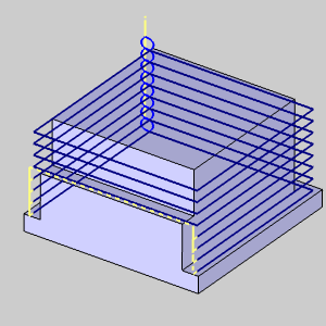

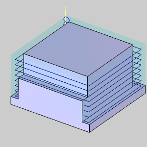

On our example part, we need to remove stock to a uniform depth on three of our four walls. The last wall only needs the top half of the stock removed. Take a moment to notice how the last four passes cut into the model. It is the last segments of the last four passes that we will need to remove.

Take a moment to look at the existing stock compared to the existing toolpath.

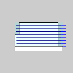

3      Rotate the part into a side view.
Notice the shorter depth of the wall on the left.

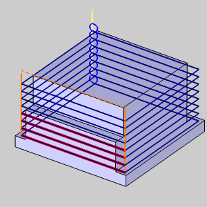

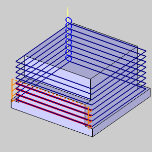

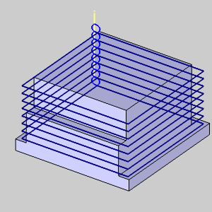

Now, we need to select the toolpath segments intersecting the solid model that we want to delete, and the lead-out moves they are connected to.
1      In the graphics area, select the toolpath elements highlighted  in the image below.
CAM_Tutorial_EditToolpath_Delete_PartStartClear.png   CAM_Tutorial_EditToolpath_Delete_PartStartSelect.png
With the toolpath segments selected, the preview is shown.

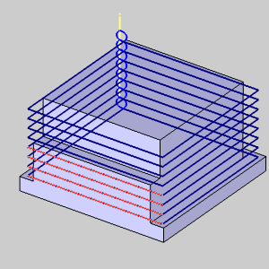

With the toolpath elements selected, we will need to set the Parameters to define how to link between the entities that still exist, since we are removing some of the toolpath. We can just leave the defaults and have the tool move to the rapid plane of the feature, but let's adjust it to stay a little lower and save some time. Be very cautions when making rapid moves occur around the part.
1      In the Parameters group, change the Retract option to Custom.
2      Enter -0.95 for the Rapid Plane value.
The preview updates showing the new retract height.
NOTE:      When the Absolute or Incremental toggle is left at the default Absolute setting, the Rapid Plane value uses the Machine Setup as zero. As such, any height below the machine setup will be a negative value.
3      Select the Extension checkbox.
The Preview updates.
4      Enter 25 for the Extension value.

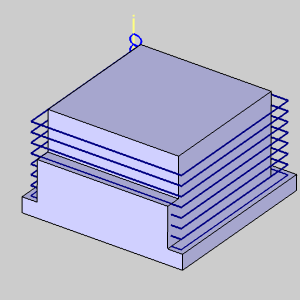

1       Click Execute.
Part 7) Viewing the Animation
1      Select the check box for Animation.
2      Use the Animation controls to play through the animation.
