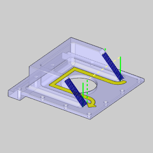

Part 1) Viewing the Toolpath

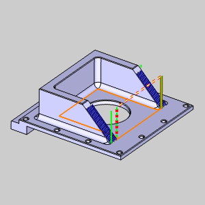

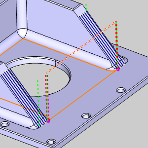

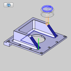

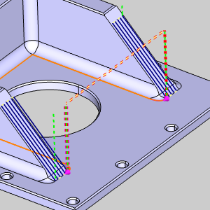

On our example part, we have created an Advanced Planar toolpath, and have used boundaries to isolate it on the angled surfaces of our part. In this case, the toopath has been separated into two separate regions, and those regions are connected with a rapid. It is this rapid we will replace with a feed move that traces around the inner fillet in the direction seen below.
1      In the Data-CAM Tree Manager, click the CAMTabIconBBCD.png CAM Tree tab.
2      In the CAM Tree, click the PlanarOpIcon.png Advanced Planar operation of the FeatureIconWhite.png Feature 3 Axis to highlight the toolpath in the graphics area.
Take a moment to look at the existing linking between toolpath regions to see what we intend to accomplish.
1      Right-click the PlanarOpIcon.png Advanced Planar operation of the FeatureIconWhite.png Feature 3 Axis.
2      Select Edit Toolpath.

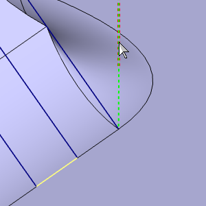

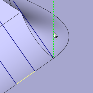

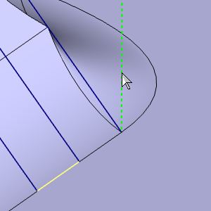

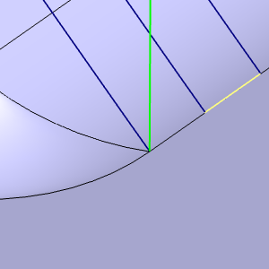

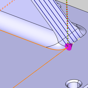

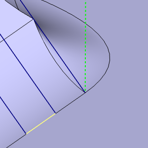

1      In the graphics area, zoom into the area shown in the image below.
CAM_Tutorial_Replace_ElementPreZoom1.png   CAM_Tutorial_Replace_ElementZoom1.png

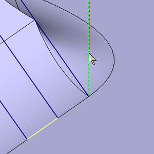

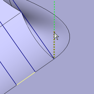

2      Hover over the lower portion of the retract move and click on the toolpath element shown below.
CAM_Tutorial_Replace_ElementZoom1Pointer.png   CAM_Tutorial_Replace_ElementZoom1Pointer2.png
Important : If the toolpath elements that highlights is not the first move of the rapid, as in the image below, be sure to include the first toolpath element in your selection as well.
CAM_Tutorial_Replace_ElementZoom1_Element2.png   CAM_Tutorial_Replace_ElementZoom1_Element2b.png   CAM_Tutorial_Replace_ElementZoom1_Element2c.png

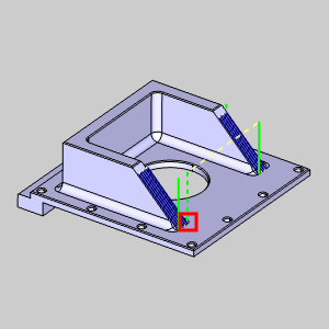

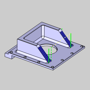

3      Zoom out in order to bring the entire model back into view.

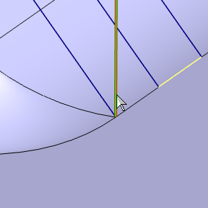

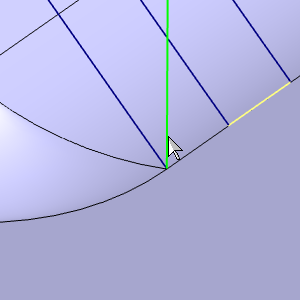

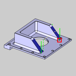

4      Now, zoom into the area shown in the image below.
CAM_Tutorial_Replace_ElementPreZoom2.png   CAM_Tutorial_Replace_ElementZoom2.png
5      Move your mouse to the end of the green toolpath element.
6      Press and hold Shift and click the bottom of the toolpath element to perform a chain selection of all the toolpath elements between.
CAM_Tutorial_Replace_ElementZoom2PointerSelected.png   CAM_Tutorial_Replace_ElementSelectionDone.png

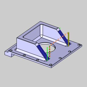

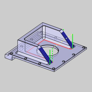

Part 5) Setting the Toolpath Chain

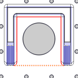

With the toolpath elements selected, we will need to set the Toolpath Chain to define the new path of the toolpath elements.
1      In the Parameters group, click the Pick button to begin selecting the Toolpath Chain.
2      Select the five individual edges on the model, as shown in the images below.
CAM_Tutorial_Replace_ChainIso.png   CAM_Tutorial_Replace_ChainIsoTrans.png   CAM_Tutorial_Replace_ChainSelectTop.png
3      With the five edges selected, right-click and select OK.pngOK.
The executable preview displays.

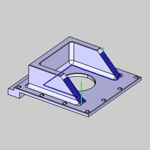

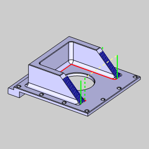

Part 6) Adjusting the Results
In some cases, depending on the direction of the Toolpath Chain, the preview may show an unintentional result, as shown in the image below. In these cases, we would need to Reverse Direction.
1      In the Toolpath Chain list, click on Chain 1 to highlight it.
The Chain highlights and shows directional arrows.
CAM_Tutorial_Replace_PreviewBadDirection_small.png   CAM_Tutorial_Replace_PreviewBadDirection.png
2      Right-click Chain 1 in the Toolpath Chain list.
3      Select Reverse Direction.
CAM_Tutorial_Replace_PreviewBadDirectionRev_small.png   CAM_Tutorial_Replace_PreviewBadDirectionRev.png
The chain reverses and the preview updates.

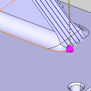

Part 7) Executing the Action
1       Click Execute.

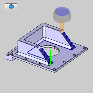

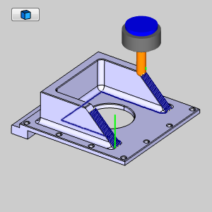

Part 8) Viewing the Animation
1      Select the check box for Animation.
2      Use the Animation controls to play through the animation. With either the ToolpathEditor_Animation_SolidIcon.png (Solid), ToolpathEditor_Animation_TransparentIcon.png (Transparent), or ToolpathEditor_Animation_WireframeIcon.png (Wireframe) view.
CAM_Tutorial_Replace_Animation_Solid.png   CAM_Tutorial_Replace_Animation_Trans.png   CAM_Tutorial_Replace_Animation_Wire.png
