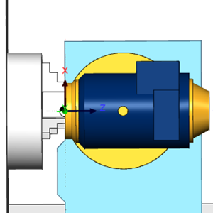

The following images show the two most common ways that a milling spindle is oriented when set to zero degrees on the physical machine. This orientation should be used when defining the parameters for the milling spindle as well as the tool direction parameters (as though a tool is mounted to the spindle in this orientation).
Milling Spindle Zero Degree Orientation (Z Axis) |
Tool Axial Direction = Z |
Tool Radial Direction = X |

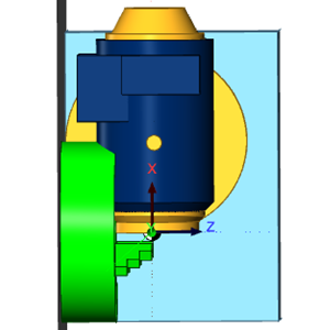

Milling Spindle Zero Degree Orientation (X Axis) |
Tool Axial Direction = X |
Tool Radial Direction = Z |
