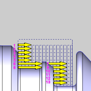

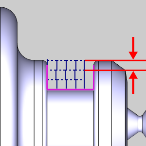

DepthsThe Multiple Depths group allows you to break the total groove depth into steps rather than just one full depth cut or pecked cut.
Depth of Cut - allows you to set the spacing between depth passes.

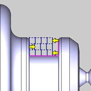

Processing - allows you to handle instances where the selected geometry causes the toolpath to be broken along a number of passes. This will allow you to decide how the tool will move between the separated areas of toolpath.

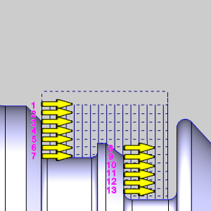

By Area - will complete
all depth passes on whole area before moving to next.
By Level - will
cut all areas of the part to the current pass depth before beginning the
next.
By Area |
By Level |

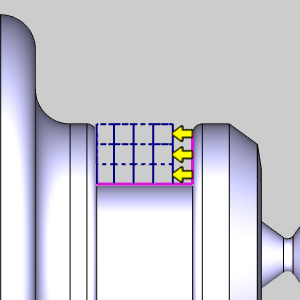

Sorting - allows you to set the operation to be cut in a single direction or a back and for motion.
One Way - forces
each pass to be cut in the same direction.
Zig Zag - forces
each pass to be cut in opposing direction.
One Way |
Zig Zag |

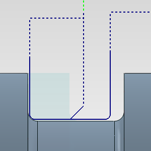

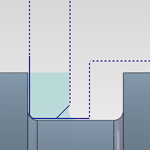

Trim to Stock -
Selecting this option will trim away toolpath that extends beyond
the Operation Stock.
Trim to Stock off |
Trim to Stock on |
Extension
- When trimming causes gaps in the toolpath, Extension closes the gap
from each side by the amount entered. This is done to create a lead out
of, and back into the material.
