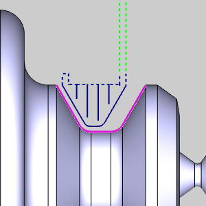

Stepover - sets the spacing between toolpath passes.
Rough Allowance -
Selecting this option will create a pass before the final
pass to act as a semi-finish. The spacing of the semi-finish pass will
be dictated by the values entered in the Z and X boxes.

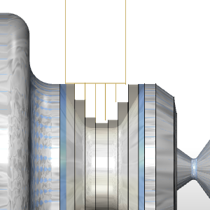

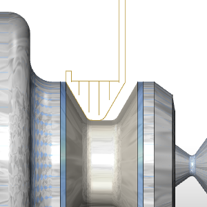

Semifinish Pattern - Once a Rough Allowance has been selected, the Semifinish Pattern will allow you to select between a one directional semifinish, or a semifinish that forces a downward cut.
Force Down Cutting -
selecting this option will force the semifinish to be cut from each side
of the groove one at a time, each in a downward direction, to the middle
of the groove. Adding an overlap will set each pass to go past the center
of the groove half the specified amount.
Overlap - sets the total distance between the two passes exits, not including any leads that are uses.

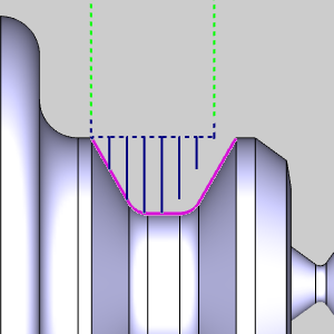

Force Down Cutting Off |
Force Down Cutting On |
With Overlap |
Basic Finish - sets
the semifinish pass to one single direction.
No Allowance |
Finish Allowance |
Rough & Finish |
No Allowance Simulation |
Finish Allowance Simulation |
Rough & Finish Simulation |

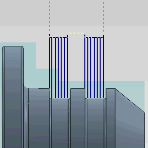

By Area - will complete
all depth passes on whole area before moving to next.
By Level - will
cut all areas of the part to the current pass depth before beginning the
next.
By Area |
By Level |

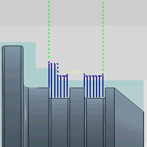

Sorting - allows you to set the operation to be cut in a single direction or a back and for motion.
One Way - forces
each pass to be cut in the same direction.
Zig Zag - forces
each pass to be cut in opposing direction.
One Way |
Zig Zag |

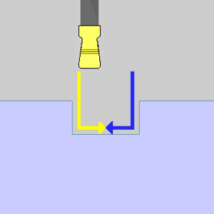

PeckingPecking allows you to set incremental depths, clearances and retracts.
First Peck Amount - sets the amount of material removed during the first entry into the material.
Peck Clearance - sets the height above the material from which the tool speed changes from rapid to feed (for each peck).
Peck Increment - sets the amount of material that is removed by each pass performed after the first peck.
Peck Retract - sets the distance that the tool
retracts between each peck.
