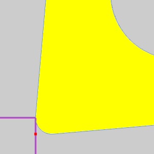

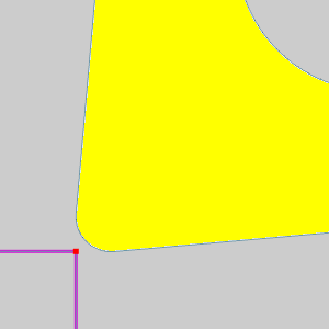

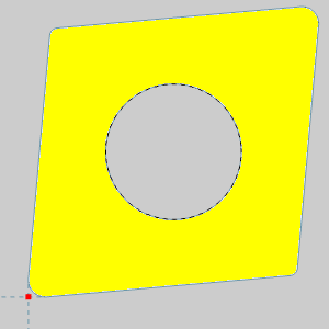

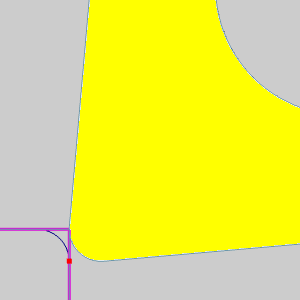

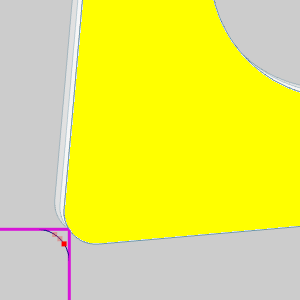

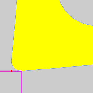

Corner Type
RadioButtonSelected.png Round - keeps the specified tool geometry in contact with the geometry at all times.
RadioButtonClear.png Sharp - allows the tool to move off the geometry in order to line up with the next move on the following entity. This method eliminates the rounding over of the tool.
Theoretical Point on Tool
Rounded Corner
Sharp Corner
