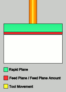

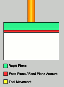

Peck - From the Feed Plane, Peck will move
at the Plunge Feedrate to the Peck Depth, return to the Feed Plane
with a rapid move, rapid down to a point above the last depth
equal to the amount of the Feed Plane being used, before continuing
to the next Peck Depth amount at the Plunge Feedrate. This method
will be repeated until the full Depth of Cut is reached.
Peck
Depth - sets the increment to use for each peck.
Click
here to see a Peck to full Depth of Cut.
Fast Peck - From the Feed Plane, Peck will
move at the Plunge Feedrate to the Peck Depth, Rapid up to an
amount equal the Feed Plane being used, before continuing to the
next Peck Depth amount at the Plunge Feedrate. This method will
Peck
Click
here to see a Fast Peck to full Depth of Cut.

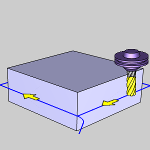

Parallel
- generates a linear feed move into the feature parallel to the toolpath
using the specified length.

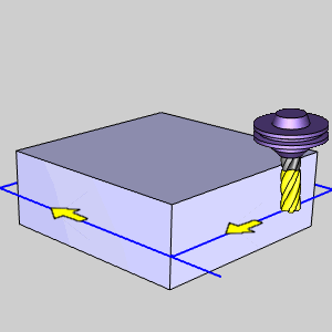

Right
Angle - generates a linear feed at a right angle to the
toolpath using the specified length.

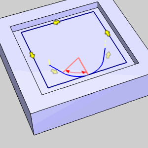

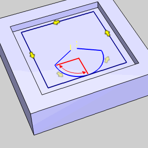

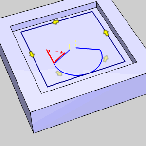

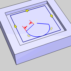

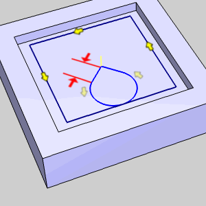

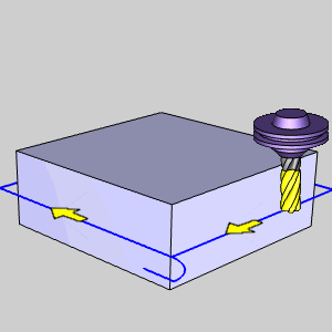

Circular
- creates a linear move followed by an arc sweep into the start of
the feature. You have complete control over both the line move and
the arc move using the following settings.
Line
Arc
Line
Arc
Line
Arc

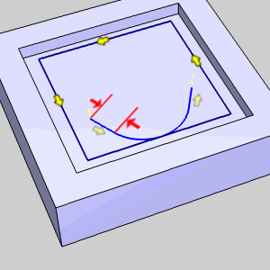

Blend
- generates a linear move and then an arc move into the feature. This
lead type can be used to lead-in and lead-out of the feature from

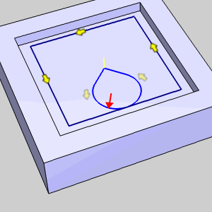

the same point. The blend lead type creates a tangent path into the
feature.

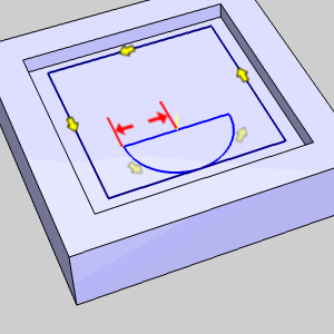

Circular
feature.
