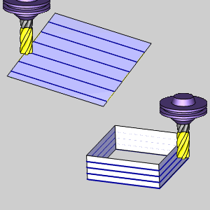

Machining Angle in XY - sets the machining angle in the XY plane. The toolpath is created perpendicular to the line created by this angle. A value of zero creates passes that are parallel to the Y-axis and a value of ninety creates passes parallel to the X-axis of the machining origin.
Constant Z - creates a constant Z-depth toolpath. When you click this button, the Machining Angle in XY is set to zero, and the value becomes unavailable. You can still alter the Machining Angle in Z parameter to modify the toolpath direction.
Machining Angle in Z - sets the machining angle in the XZ plane.
Parallel - creates a parallel or planar-style toolpath. When you click this button, the Machining Angle in XY is set to zero and the Machining Angle in Z is set to ninety. You can still alter both values to modify the toolpath direction.

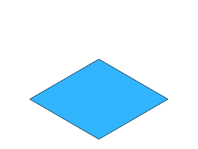

Drive surfaces - enables selection mode for you to select the Drive Surfaces geometry. The toolpath is applied to the selected surfaces.

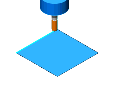

Cuts parallel to the Y-axis - XY angle = 0 degrees and Z angle = 90 degrees.
Cuts parallel to the X-axis - XY angle = 90 degrees and Z angle = 90 degrees.

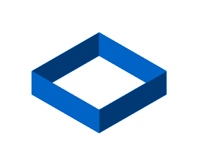

Constant Z Cuts - type a Machining Angle in Z of 0 degrees or select Constant Z. The Machining Angle in X,Y becomes unavailable.
