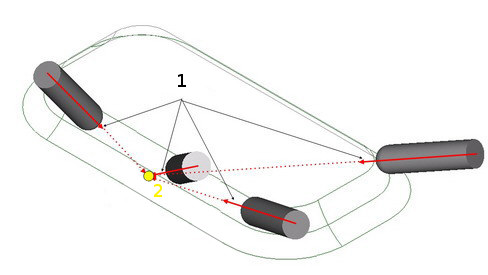

Tilted from Point Away
The Tilted From Point Away tilting strategy uses a point that it located under the drive surface. The tool axis always tilts away from the selected point.
IMPORTANT:     When the surface normal is parallel to the selected tilt axis, it is not possible to span the plane. The result is that the tool axis won't be tilted even though you have set a tilt angle. The point must be located below the drive surface. Make sure that it is not above or exactly on the drive surface.
The point (2) is located under the geometry. During machining the tool axis is always aligned from the point-away (1).
