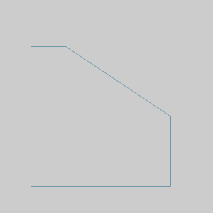

Part 2) Using the Between 2 Entities Method
1      Open Fillet / Chamfer by selecting LineChamfer.png Chamfer from the Line menu, or by selecting ArcFillet.pngFillet from the Arc menu.
The Fillet / Chamfer  parameters display in the Data Entry tab of the Data-CAM Tree Manager with Chamfer selected as the Type.
Notice the Picking Method is set to the default of Between 2 Entities, and the Chamfer Method is set to the default of Angle-Distance 1.

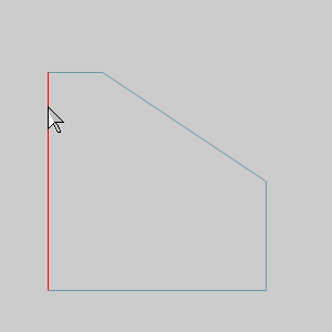

2      With the Parameters left at their default settings, click the left hand vertical line as seen in the image below.

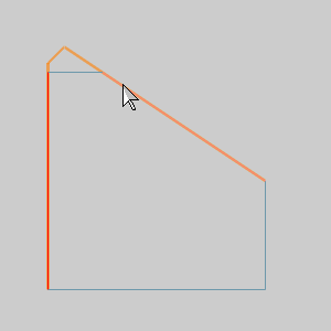

3      Hover over, but do not select,  the angled line on the right as seen in the image below.
Notice this line could be selected even though it is not currently connected to our first line. Because the two could intersect, they can be extended to create the chamfer.

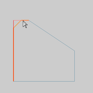

4      Click the top horizontal line as seen in the images below.
CAD_ArcLines_FillCham_TrueNextLineHover.png   CAD_ArcLines_FillCham_FirstChamfer.png
a 45° Chamfer is created.

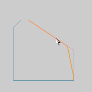

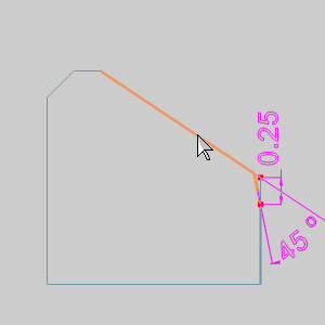

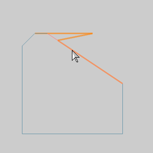

Part 3) Using the Single Corner Click Method
1      In the Picking Method group, select the Single Corner Click method.

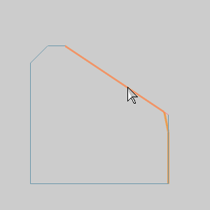

2      Hover over, but do not select,  the top half of the angled line on the right as seen in the image below.
Take a moment to notice how these Parameter values are being applied.
3      Hover over, but do not select,  the bottom half of the angled line on the right as seen in the image below.

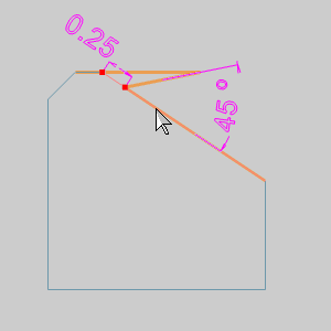

Part 4) Using the Angle-Distance 2 Parameter

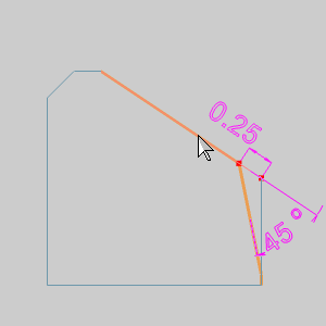

1      Change the Chamfer Method to Angle - Distance 2.
2      Hover over, but do not select,  the bottom half of the angled line on the right as seen in the image below.
3      Click the bottom half of the angled line on the right to achieve the result seen in the image below.

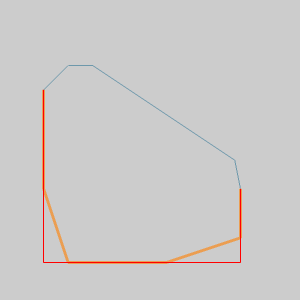

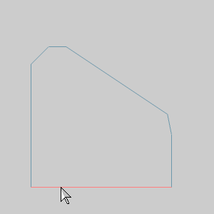

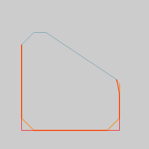

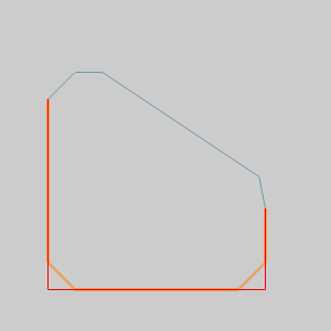

Part 5) Using the Chains Method
1      Change the Picking Method to  Chains.
2      Hover over the bottom horizontal line as seen in the image below.
3      Hold Shift and click the line to chain select the entire chain.
As you can see, we can pick entire chains to apply chamfers and fillets to. We can also deselect entities as we will see in the next step.

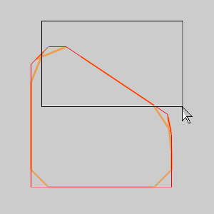

4      Move your mouse above the geometry and to the left without going past it. Hold the left mouse button and drag a window down and just above the last chamfer we created, as seen in the image below.
5      Release the left mouse button to deselect the enclosed geometry.
6      Now we will remove the chamfer from our selected chain by using the Selected Geometry list. Click on Line-8 in the Selected Geometry list.
The entity highlights in the graphics area.
NOTE:      The names of the entities in the Selected Geometry list are based on the number of entities in the file. If other entities have been created in this file the name of the entity in the Selected Geometry list may differ.
7      With Line-8 highlighted, click the Icon_WPF_Delete.png (Delete) or press Delete on your keyboard.
The entity is removed from the list and is no longer highlighted in the graphics area.

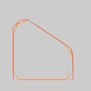

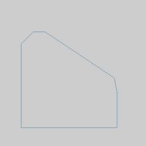

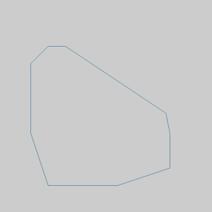

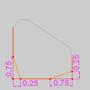

Part 6) Using the Distance 1-Distance 2 Parameter
1      Change the Chamfer Method to Distance 1-Distance 2.
2      Change the Distance 1 value to 0.7500.
The preview updates. Notice how the 0.7500 value is being applied.
3      Click OK to confirm the chamfers.

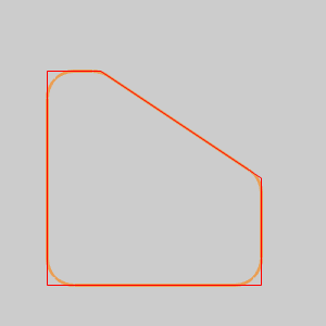

Part 7) Pasting Geometry
1      In the Layers tab of the Layer-UCS-Post Manager, right-click and select Add New Layer.
A new layer is created with the name "Not Named". Upon creation the name is highlighted to allow you to rename.
2      Name the new layer Fillet and press Enter.
The layer is renamed.
3      Right-click the Fillet layer and select Active Layer.
The Fillet layer is active and future CAD creation will be on this layer.

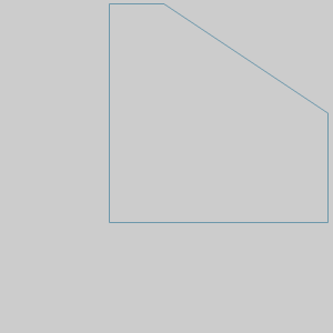

4      Right-click the CAD layer in the Layers tab of the Layer-UCS-Post Manager and select Hide to hide shape with Chamfers.
5      Click in the graphics area and press Ctrl+V to paste the geometry copied in the beginning of this example.

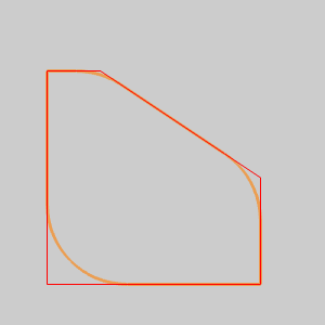

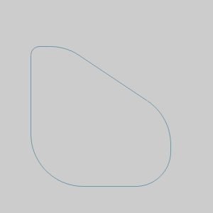

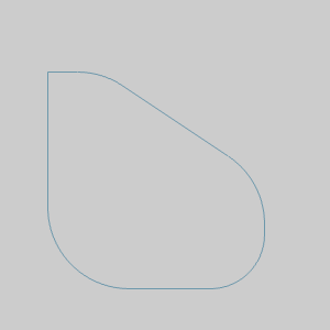

Part 8) Creating Fillets with the Chains Method
1      Change the Type to Fillet.
The preview appears. Notice that each angle has a fillet applied.
4      In the Parameters group, change the Radius value to .7500.
The preview appears. Notice that a fillet is only applied where possible.
5      Click OK to confirm the fillets.

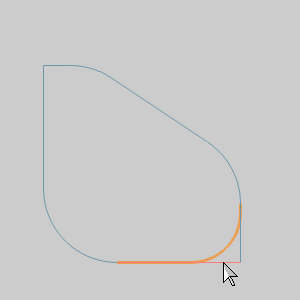

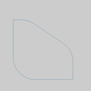

Part 9) Using the Single Corner Click Method
1      In the Picking Method group, select Single Corner Click.
2      In the Parameters group, set the Radius value to 0.3750.
3      Click the right side of the lower horizontal line, as seen in the image below.
CAD_ArcLines_FillCham_FilletSingleClick_0375.png   CAD_ArcLines_FillCham_FilletSingleClick_Confirm.png
The fillet is created.

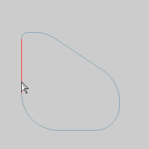

Part 10) Using the Between 2 Entities Method
1      In the Picking Method group, select Between 2 Entities.
2      In the Parameters group, set the Radius value to 0.1250.

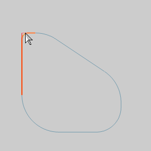

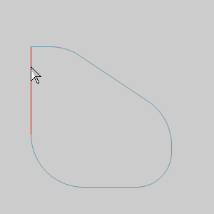

3      Click the left vertical line as seen in the image below.
4      Click the top horizontal line as seen in the image below.

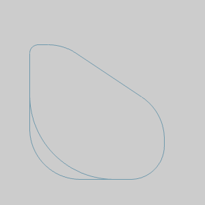

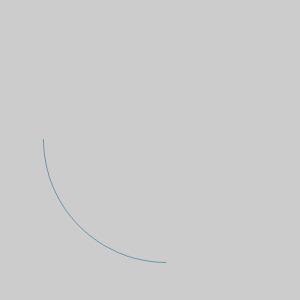

Part 12) Creating a Separate Fillet
1      Clear the Trim check box above the OK button.
This will allow us to create a fillet without trimming any of our existing entities.

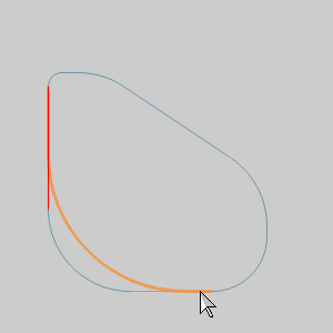

2      In the Parameters group, change the Radius value to 1.2500.
4      Click the bottom horizontal line as seen in the image below.
CAD_ArcLines_FillCham_FilletBetween2_LastSecondPre.png   CAD_ArcLines_FillCham_FilletBetween2_LastSecondFinal.png

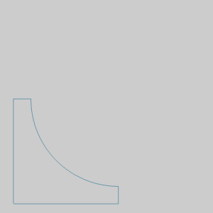

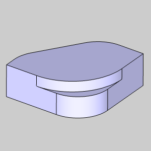

TIP:   This can be helpful when we are trying to avoid altering the original shape. In the images below, we have used the new fillet to create a closed shape that can be used to do an Extrude Cut from a extrusion of our original shape.
CAD_ArcLines_FillCham_LoneFillet_ClosedShape.png   CAD_ArcLines_FillCham_LoneFillet_ExtrudeCut.png
