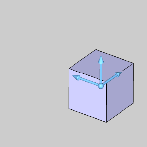

Part 1) Create a Cube
1      In the File menu, click New.
A New window opens.
2      Enter into an ISO 2 view by pressing Ctrl+7.
3      Open Cube.png Cube by selecting the function from Solids menu.
The Cube parameters display in the Data Entry tab of the Data-CAM Tree Manager.
The Preview appears.
4      The cube being created will be left at the default size, and location.
Click OK to confirm the cube.
The Cube is created in the graphics area and a Cube.png Cube feature is created in the CADTreeIcon.bmp CAD Tree.

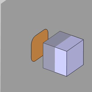

Part 2) Unstitch the Cube
1      In the Utilities menu, hover over Stitching, and select Unstitch Surface from Solid.

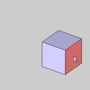

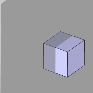

1      Hover over the surface as seen in the image below.
The surface highlights.
2      Click the surface.
The surface is no longer highlighted until the mouse is moved again.
No change is visible, but the surface is unstitched from the cube and an UnstitchSurfaceFromSolidIcon.png Unstictch Surface from Solid feature is created in the CADTreeIcon.bmp CAD Tree.
3      Click Cancel to exit the function.

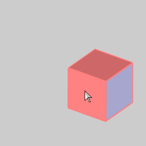

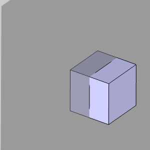

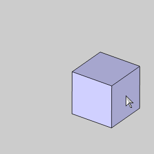

4      Hover of a different surface of the cube as seen in the image below.
Notice the surface has been unstitched from the cube.

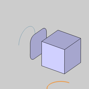

Part 5) Create an Arc
1      Open the ArcCoords.png Arc Coordinate function by clicking on ArcCoords.png Coordinates in the Arcs menu.
The Arc Coordinate dialog opens in the Data Entry tab of the Data-CAM Tree Manager and the Preview displays.
2      Update the values in the Arc Coordinate dialog to match the following:
Center X
Center Y
Center Z
Radius
Start Angle
End Angle
=  0.0000
=  0.0000
= -3.0000
= 1.0000
= 0.0000
= 180.0000
The Preview updates.
3      Click OK to confirm the placement of the arc.

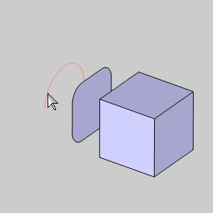

Part 7) Extrude the Arc
1      Open the ExtrudeCurve.png Extrude Curve function by clicking on that option in the Surfaces menu.
The Extrude Curve dialog opens in the Data Entry tab of the Data-CAM Tree Manager.
2      Hover over the arc as seen in the image below.
3      Click the arc.

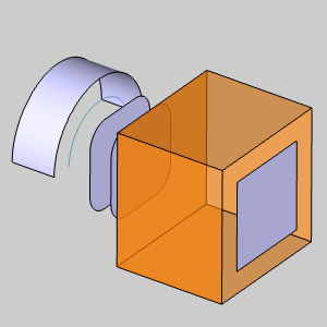

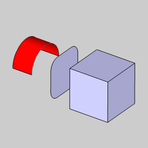

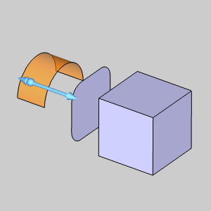

Part 8) Offset Without Keeping the Original
1      Open the SurfaceOffset.png Offset function by clicking on that option in the Surfaces menu.
The Offset Surface dialog opens in the Data Entry tab of the Data-CAM Tree Manager.

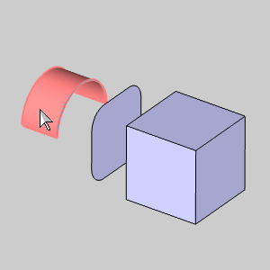

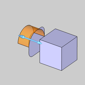

2      Hover over the extruded arc as seen in the image below.
3      Click the surface.
The surface is selected and is added to the Selected Geometry list.
4      In the Parameters group, change the Distance to 0.5000.
5      Next to Options, click WPF_DownArrow.png to access the options.
6      Clear the check box for Keep Original.
The offset we create will now replace the original surface.
7      Click Show Preview.
8      Click OK to confirm the surface.

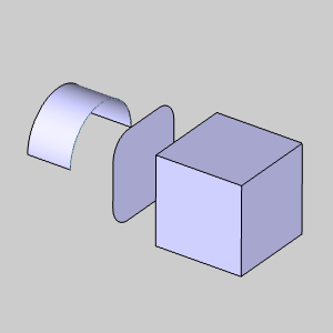

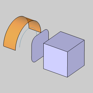

The offset is created in the graphics area and an SurfaceOffset.png Offset Surface feature is created in the CADTreeIcon.bmp CAD Tree.

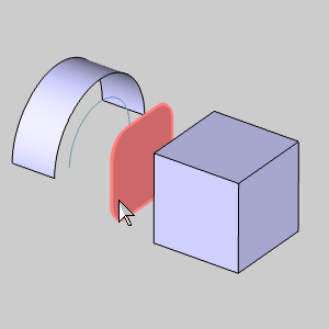

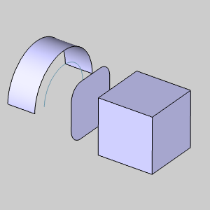

Part 9) Offset and Keep Original

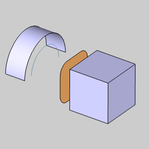

1      Hover over the rectangular plane as seen in the image below.
2      Click the rectangular plane.
The rectangular plane is added to the Selected Geometry list.
With the Show Preview button still selected, the Preview automatically appears.
3      In the Parameters group, change the Distance value to -0.5000.
4      In the Options group, select the check box for Keep Original.
The offset we create will now be in addition to the original surface.
5      Click OK to confirm.

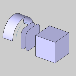

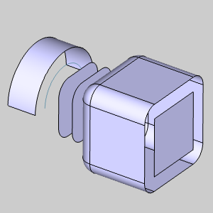

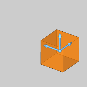

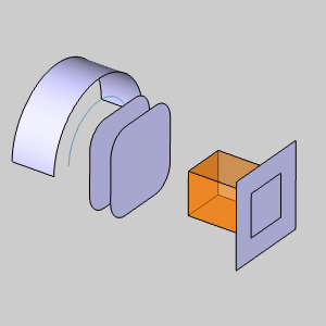

Part 10) Offset with Filleted Edges
1      In the Options group, clear the check box for Fillet Edges.

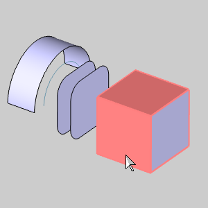

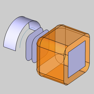

2      Hover over the cube as seen in the image below.
3      Click the cube.
The cube is selected and added to the Selected Geometry list.
4      In the Parameters group, change the Distance value to 0.5000.
5      In the Options group, select the check box for Fillet Edges.
6      Click OK to confirm.
The offset is created in the graphics area and another SurfaceOffset.png Offset Surface feature is created in the CADTreeIcon.bmp CAD Tree.
