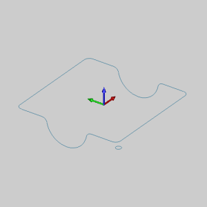

This example will demonstrate how to use the Sweep function.
NOTE:      In the images below, the Show Axis X-Y toggle has been disabled in the Axis X-Y group of the Settings Part > Display dialog. The Gnomon has been used to show the Sweep Profile in the X,Y Plane.

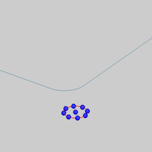

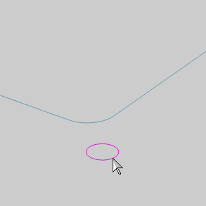

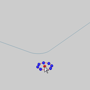

5      The first step is to select a point or snap point to assign as the Attachment Point of the Sweep Profile to the Sweep Path.
Press and hold Shift, and click the small arc to display the snap points of the arc.
CAD_Surfaces_SweepEx_ProfileHover.png   CAD_Surfaces_SweepEx_ProfileShiftClick.png

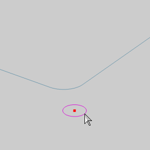

6      Click the snap point in the center of the arc to select it.
CAD_Surfaces_SweepEx_ProfileHoverCenterSnap.png CAD_Surfaces_SweepEx_ProfileCenterSnapSelect.png
The point is added to the Attachment Point list and the focus is moved to the Sweep Profile list.
NOTE:      When selecting the attachment point of the sweep profile, you don't always have to show the snap points first. You can click an entity near the snap point that you want to use and the software automatically selects the closest snap point of the entity. Showing the snap points may make the selection easier though for some geometry. With arcs, for example, you have to show the snap points to select the snap point at the arc center.

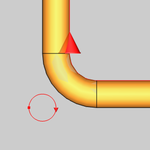

7      The next step is to select the Sweep Profile itself.
Press and hold Shift, and click the arc to select it define he profile geometry that is swept along the Sweep Path.
CAD_Surfaces_SweepEx_ProfileSelectHover.png   CAD_Surfaces_SweepEx_ProfileSelected.png
The chain is added to the Sweep Profile list and the focus is moved to the Sweep Path list.
NOTE:      Because our Sweep Profile is a single entity, we used chain selection to define the start and end of the profile in one click. If you were using a group of connected entities as the sweep profile, you can still use this method, or you can click the start entity first, and then hold shift and click  the last entity to define the end of the sweep profile. This method is helpful when you have a group of connected entities, but you don't want to select them all. An example of this selection method is performed in the next step.

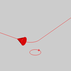

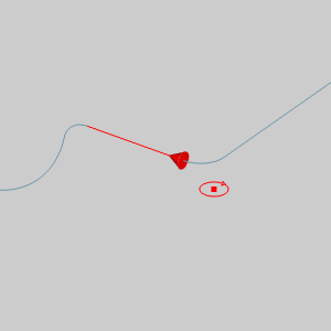

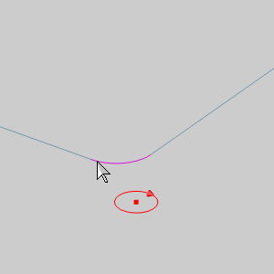

8      The next step is to select geometry as the Sweep Path. Because we are selecting a closed sweep path, we could just hold Shift and click anywhere along the path to select it and define the direction in one click. Instead, we use the two click method and skip an entity to show how it is done.
Click the end of entity shown below to set the start of the sweep path.
The start arrow of the sweep path displays.
CAD_Surfaces_SweepEx_PartialHover1.png   CAD_Surfaces_SweepEx_PartialShiftSelect1.png

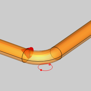

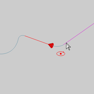

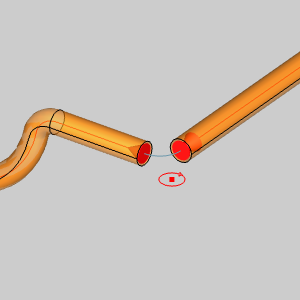

9      To set the end of the sweep path, hold Shift and click near the end of the entity shown below.
The Preview displays.
NOTE:      Even though the chain for the sweep path is a closed path, we have selected the chain in such a way that we have avoided including a particular entity. Had we held Shift when clicking the first entity of the sweep path, all entities would have been included.

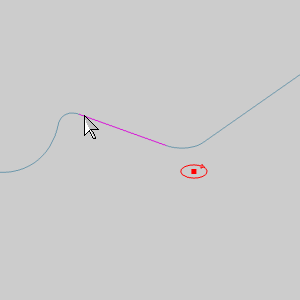

10  Next to the Sweep Path list, click Icon_WPF_Delete.png (Delete) to remove the partial chain from the list.
The Preview disappears.
11  Hold Shift and select an entity of the sweep path as shown below.
The Preview updates.

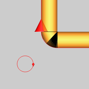

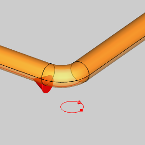

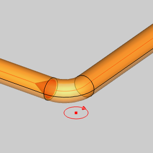

12  To finalize this result, we would click OK. Before we do that, we will test different Attachment Points by repeating the following three steps:
A     Click Icon_WPF_Delete.png (Delete) next to the Attachment Point list to remove the existing point.
The Preview and the Attachment Point disappears.
B      Click in the Attachment Point list to give it focus.
C      With the available snap points of an arc in mind, click one to test a new Attachment Point.
Repeat steps A,B, and C to get the following results.

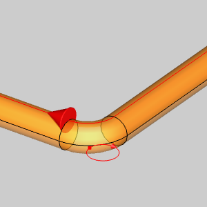

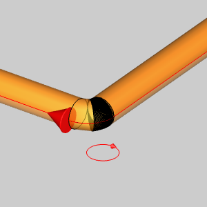

ISO 2 View
ISO 2 View
ISO 2 View
ISO 2 View

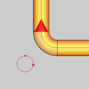

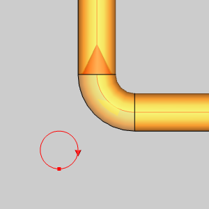

Top View
Top View
Top View
Top View

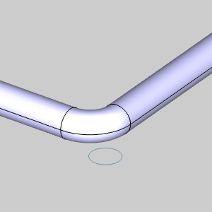

13  Click OK to finalize the previewed result.
The surface is created in the graphics area  and a SurfaceSweep.png Sweep feature is created in theCADTreeIcon.bmp CAD Tree.
CAD_Surfaces_SweepEx_CenterISOResult.png   CAD_Surfaces_SweepEx_WholeResult.png
NOTE:      The Result shown in the image above uses the center of the arc as the Attachment Point.
