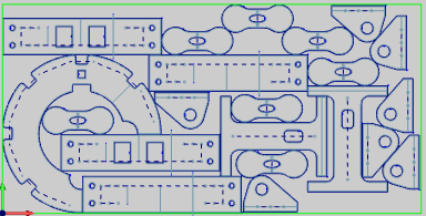

Now that the nest has been generated, we will want to make sure all the parts quantities fit on the sheet.
1 In
the CAM Tree, right-click on
Sheets and select Show Summary. Here we can see we have
three leftover parts. We will attempt to adjust the result to fit the
others on the sheet as well.
2 Click
OK at the bottom of the Nesting Summary to close it.
Now that the nest has been generated and we can see there are a few parts that have not been fit, we will try to adjust a setting to get a better result.
1 In
Nesting Job and select edit to launch the Nesting Wizard again.
2 Click
Nesting Parameters in the tree to jump to the
Nesting Parameters page.
3 Click
the Other Options button to launch the Other Options dialog box.
4 Select
the check box for Best Nesting Direction and click OK to finalize changes
and close the Other Options dialog box.
5 Click
Compute at the bottom right of the Nesting Wizard.

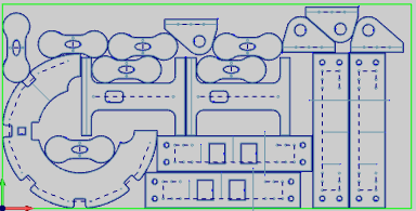

Now that the nest has been regenerated, we will want to check to see if the change we made to the Nesting Parameters has helped eliminate leftover parts.
1 In
no leftover parts.
2 Click OK at the bottom of the Nesting Summary to close it.
Now that the nest has been generated and all the parts fit on the sheet, we will check the simulation to visualize the machining order prior to posting the code.
1 Right-click on the Nesting Job and select Simulation
to enter into the simulator to check the final result. Learn more
about the simulation here.
