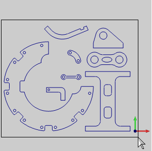

1      Open the New_Nesting_Tutorial1.bbcd file from the C:\BobCAD-CAM Data\BobCAD-CAM V28\Examples folder. Note that when creating a nest, the original location of the parts is not important. The parts in this file have been moved off to left because we will be setting up our sheet in the X+,Y+ quadrant. This will make things a little easier to see once the nest has been completed.

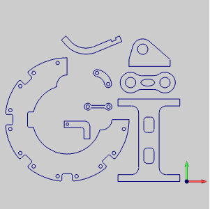

2      Drag a window around all of the parts in the workspace.
3      Once all of the parts are highlighted, right click in the workspace and click OK to confirm the part selection.
IMPORTANT:     The window selecting geometry is not recommended unless you are absolutely sure the geometry is clean. If you are not sure the geometry is clean, use a chain selection method to pick one chain at a time. Find out more about chain selection here.
4      The Nesting Wizard returns, and the eight separate parts are listed in the Part List area.

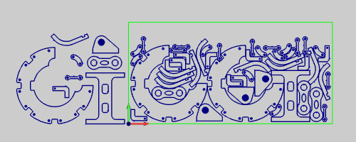

7      The Nest is recomputed and the toolpath result is shown.

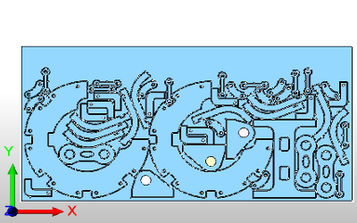

2      Here we can see we have no leftover parts. In this case all of our parts have been nested. This summary will also give us an idea of how much of the sheet we have used. Click OK to close the Nesting Summary.
3      Right-click on the Nesting Job and select Simulation to enter into the simulator to check the final result. The image below is the final result. Learn more about the simulation here.

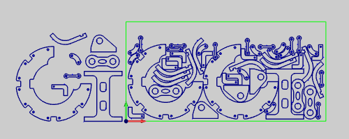

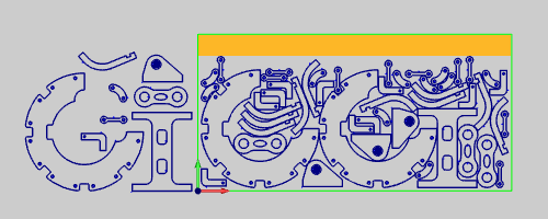

Now that the machining we intend to do has been verified in the simulation, the only other question would be whether or not we are satisfied with the final nested result. While it is true that we have managed to fit all of our requested parts on the sheet, we may want to use the portion of the sheet with no parts nested on it for future nests. This would be referred to as a remnant sheet. BobCAD-CAM users that have the Pro version of our Nesting package have a lot of tools to get this done a little cleaner, but even Standard users are able to utilize remnants themselves. Let us look at our nested result and what area of the sheet remains to possibly use in the future.
While there is some space at the top, which is visualized in the next image, there is not a lot of room for larger parts. Lets see if we can adjust the nest to produce a wider area.

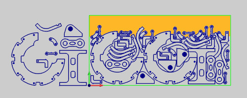

1      Right-click on the Nesting Job and select Edit to get back into the Nesting Wizard to make one small adjustment.
2      Now click on the Sheet Parameters in the tree on the left side of the wizard to jump to Sheet Parameters page.

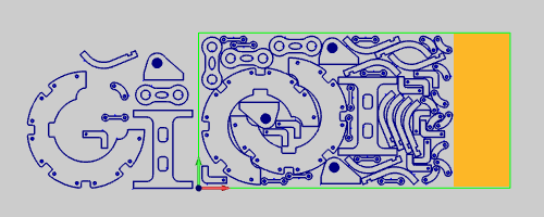

3      In the Additional Sheet Parameters group change Fill Sheet from Vertical (Y) to Horizontal (X) and click Compute at the bottom right of the wizard to compute those changes.
Shown here you can see the actual usable material from one result to the next
Vertical (Y)
Horizontal (X)
