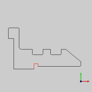

1 Open the Lathe_Basics_Tutorial.bbcd file.
NOTE: The wireframe geometry is flat in the X/Y plane and in the X-/Y+ quadrant. When creating a Turning Job, this is the quadrant in which your geometry should be located.

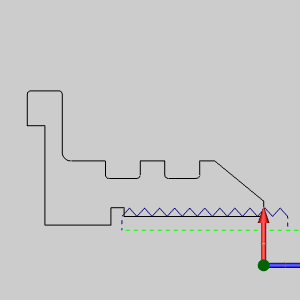

For most every Turning Job, you will need to face off the stock. By selecting a Lathe End Face feature, we will automatically create toolpath up to the machine zero without the need to select geometry. The only time geometry will need to be selected for the Lathe End Face feature is if the desired toolpath needs to end before, or, continue beyond the machine zero.
1 In
the
CAM Tree, right-click
Machine Setup - 1 and select Lathe End Face.
The Lathe End Face feature launches with the Geometry Selection page active.
Since our target geometry is already at the machine zero, we do not need
to select geometry.
2 Click
Next>> to continue to the
Feature page.
1 Select the Extension check box and, in the End Distance box, enter a value of 0.1000.
TIP: Since the Lathe End Face feature ends at the inner diameter of our stock, we use a small extension so our tool radius does not leave any material.

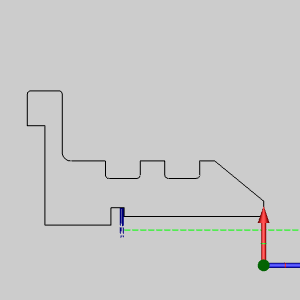

In this step we create a Lathe Turning feature, assign Rough and Basic Finish operations, and define the parameters of those operations.
1 In
the
Machine Setup - 1 and select Lathe Turning.
2 Click
Select Geometry.
The Lathe Wizard hides and selection
mode is enabled to allow geometry selection.

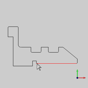

3 In
the graphics area :
a Left-click
the end of the first entity to be turned.
b Going
to the end of the last entity to be turned, hold Shift on your keyboard
and left-click again to select all the entities between the two.
c With
all entities highlighted, right-click in the graphics area and select
OK
to confirm the geometry selection and return to the Lathe Wizard.
TIP: To confirm geometry
selections, you can also click the
icon in the toolbars or simply press Spacebar.

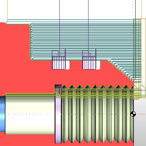

1 Right-click
the new Feature Lathe Turning
in the
CAM Tree and select Blank/Unblank
Toolpath.
In this case, we have two grooves that need to be completed on the OD
of the part and one groove on the ID. Right now we will focus on the two
OD grooves.

1 Right-click
the new Feature Lathe Groove in
the
Toolpath.
1 Right-click
Machine Setup -
1 in the
CAM Tree and select Lathe
Thread.

3 In
the graphics area:
a Left-click
the entity to the right of the ID groove. b Press Spacebar. |

1 In
the Feature page, under Feature Parameters
select ID from the Feature
Type list.
2 Select
the check box for Extension:
a In
the Start Distance box enter a
value of 0.3750.
b In
the End Distance box enter a value
of 0.0300.
3 Select
Thread.
1 Click
Tool Crib.
2 Click
THREADING and
then click Add From Tool Library.
3 Select
tool number 505 to highlight the
60 DEG - LAY
DOWN - ID THREAD .IC tool.
4 click
OK.
5 In
the Tool Crib:
a select
under Mounting Orientation.
b Click
OK.
6 Select
Parameters.
1 Under
Parameters, set Threads
Per Unit to 5.0000.
2 Select the check box for Override and set Thread Height to 0.1190.
NOTE: The Thread Height that is calculated in BobCAD-CAM is the theoretical sharp height. Depending on the thread being cut, you may need to adjust this value.
3 Click Compute.

1 In
the Modules menu, click
Simulation.
For help with simulation, view Getting Started with Simulation.
TIP: The
Simulation contains a CutSim tab.
Clicking on the
Advanced Properties button will
launch the Parameters dialog box
allowing you to select the
Enable check
box in the Section plane group.
This will put the stock in the section plane view seen in the image above.
Leave the values as they are and click OK.
