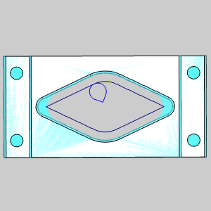

This example explains how to use the Break option in the Edit Toolpath dialog box. On our example part, we have used a solid model to set the stock to a specific shape. In this case, the stock shape shows what the first two operations have left. Due to the size of the rough tool, much more material has been left in the acute angles of our pocket. It is because of this, it would be beneficial to slow down the feedrate on our finish operation before it engages that extra material. To accomplish this, we will need to break the toolpath elements leading into, and out of, our acute angles. Once this is accomplished, we can adjust the feedrate on the specific portions of toolpath that engage the leftover material, which will be accomplished in another example. This example will have you:
The part file for this example is available for download at: http://bobcad.com/helpfiles. If you are connected to the Internet, you can click the link provided to download and save the Toolpath_Editor_Break_Example BBCD.zip file. After extracting the zip file, you can open the file to follow along with this example. In the example file provided, the stock and Machine Setup are already defined for the part, and the toolpath to be adjusted has been applied.
Take a moment to look at the stock compared to the existing toolpath to see the what we intend to accomplish.

2 In
the CAM Tree, click
Stock to view the assigned stock.

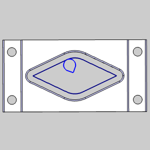

Take a moment to look at the existing stock compared to the existing toolpath
to get an idea of where we would like to break our toolpath elements.
3 In
the CAM Tree, click the Pocket operation in the feature to remove focus
on the stock and to place focus on the toolpath to be adjusted.

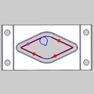

Change Parameters to the Screen Point option.

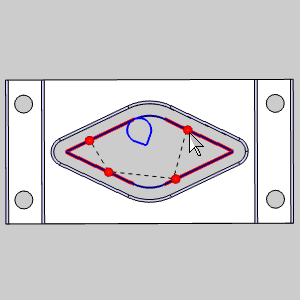

1 Select the Screen Point option in the Parameters group.
1 In the graphics area, select
the toolpath shown in the images below.

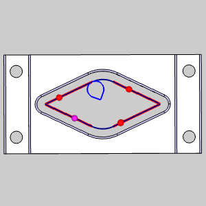

With the toolpath elements selected, we will need to define the distance of the Break Point.
1 In
the Break Point list, select Break Point
- 1.
Break Point - 1 highlights in the graphics area.
2 Change
the Distance to 70.

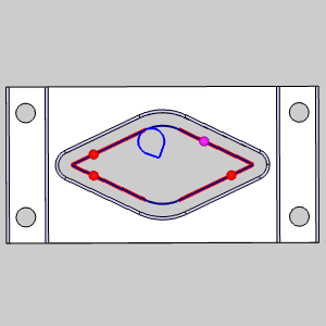

3 In
the Break Point list, Select Break Point
- 2.
Break Point -1 adjusts its position in the graphics area and Break Point
- 2 highlights.
4 Change
the Distance to 30.

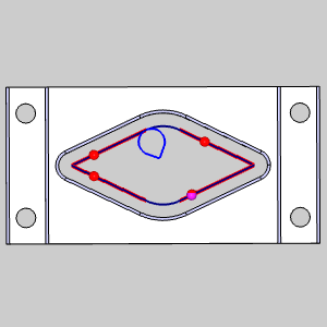

5 In
- 3.
Break Point -2 adjusts its position in the graphics area and Break Point
- 3 highlights.
6 Change
the Distance to 70.
7 In
- 4.
Break Point -3 adjusts its position in the graphics area and Break Point
- 4 highlights.
8 Change the Distance to 70.

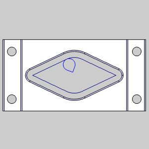

1 Click
Execute.
The toolpath elements update.

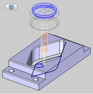

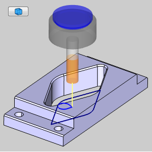

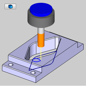

1 Select
the check box for Animation.
2 Use
the Animation controls to play through the animation. With either the
(Solid),
(Transparent),
or
(Wireframe)
view.
